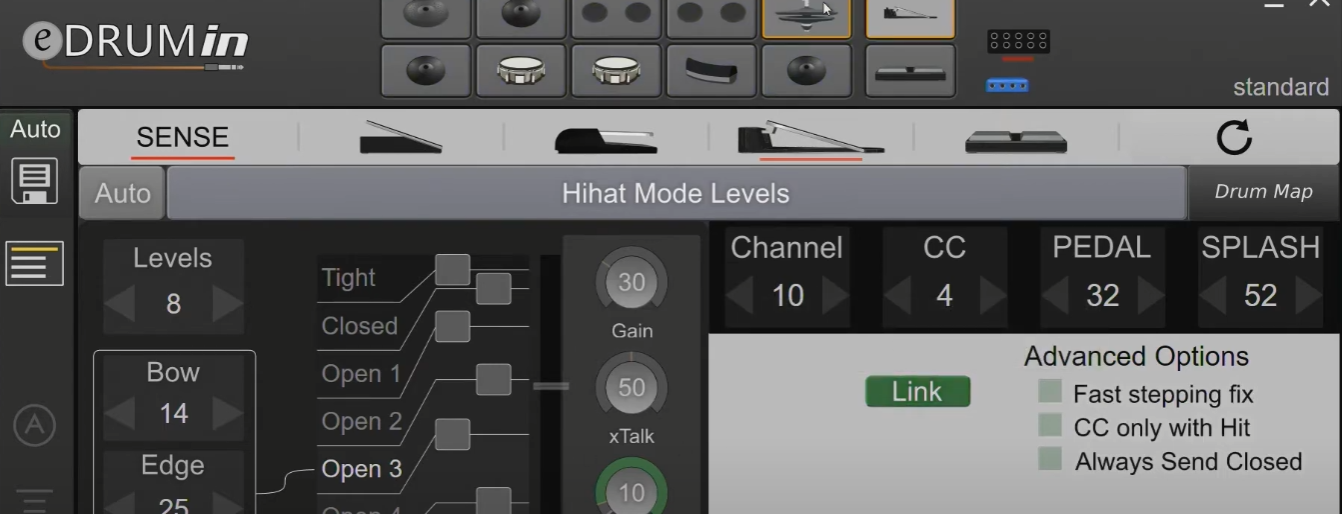

Using level mode, when I hit the trigger mapped to the hi hat and change the pedal position, the note that is output should change - it should be different than the open position. How do I make this behave like a normal hi hat?
The "Link" button as shown in this video https://www.youtube.com/watch?v=oQP2sHrCgUg does not appear in my interface.

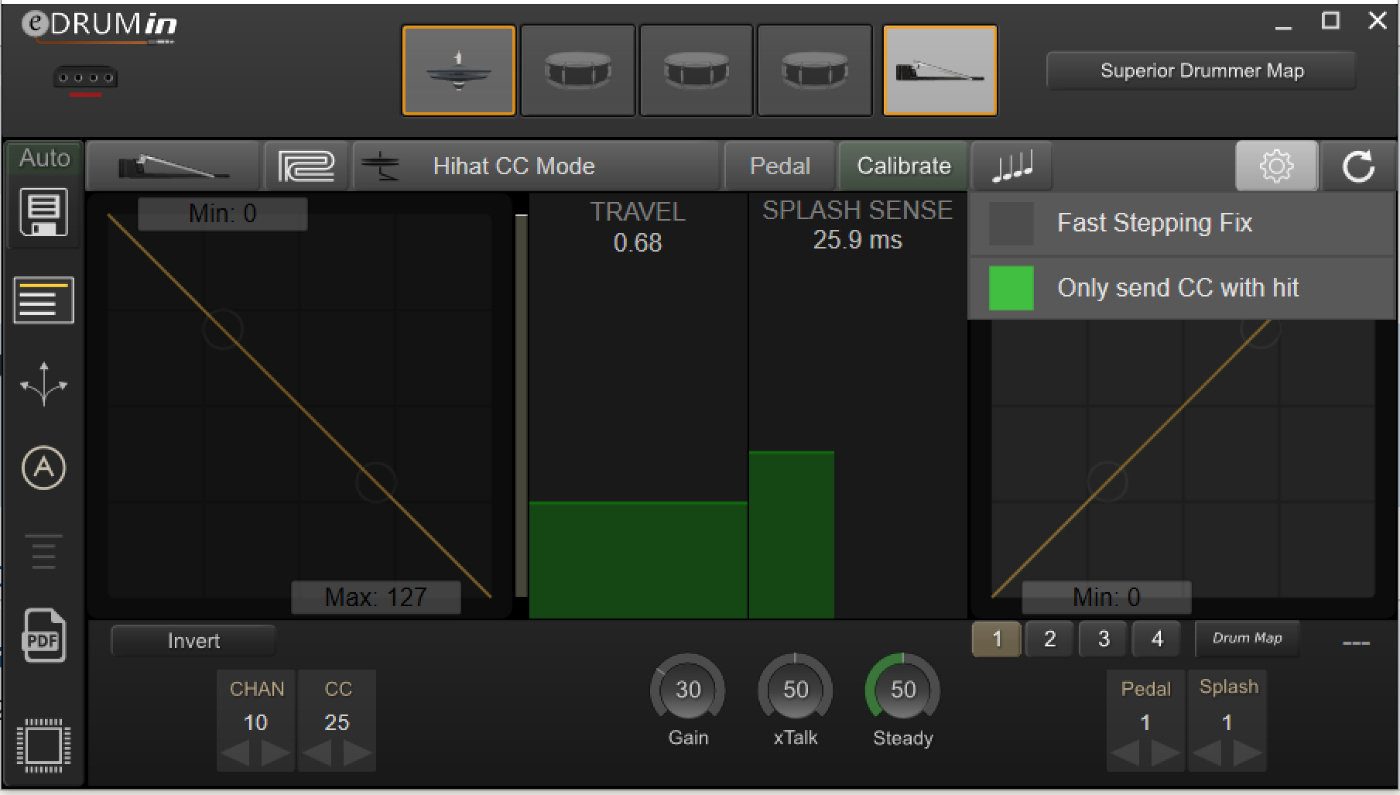

knuckledown wrote:
Sun Dec 31, 2023 7:09 pm
That video is for an older version of the eDRUMin software and the link button is now gone. There is a link to an updated version of the video in the description.
If I was trying to get an FSR to affect a drum pad, I would set my hihat pedal up like this:
  • Using hihat CC mode.
  • Hihat pedal set to use custom notes.
  • Only send CC with hit enabled.
  • CC changed from 4 to something else that isn't being used by my sampler.
  • Pedal and Splash notes are set to a note that isn't being used so that they don't make any sound.
01-01-2024, 08-09-09.png (216.31 KiB) Viewed 5901 times

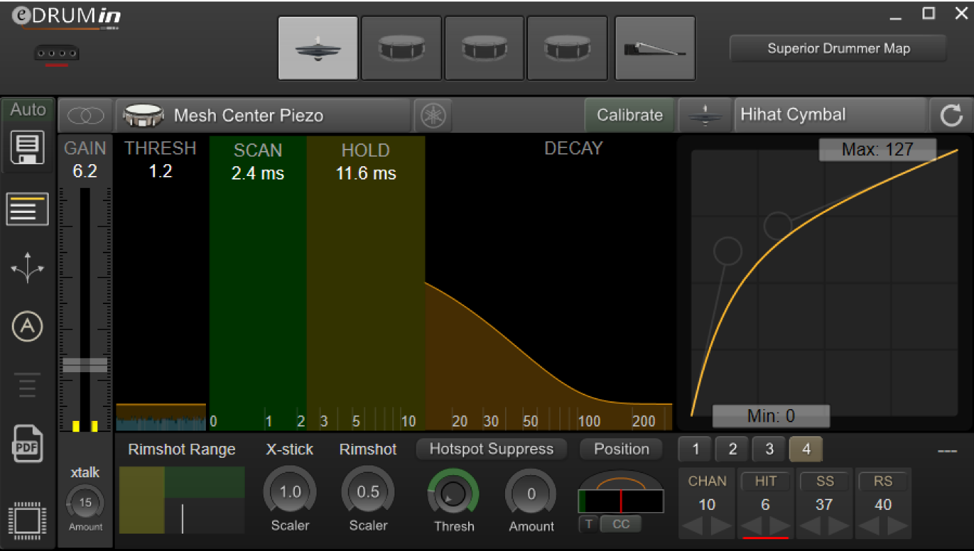

And for the drum pad...
  • Set the pad function to 'Hihat Cymbal'
  • Set the notes of my pad to match the notes needed to trigger my snare.
01-01-2024, 08-13-58.png (254.92 KiB) Viewed 5901 times
