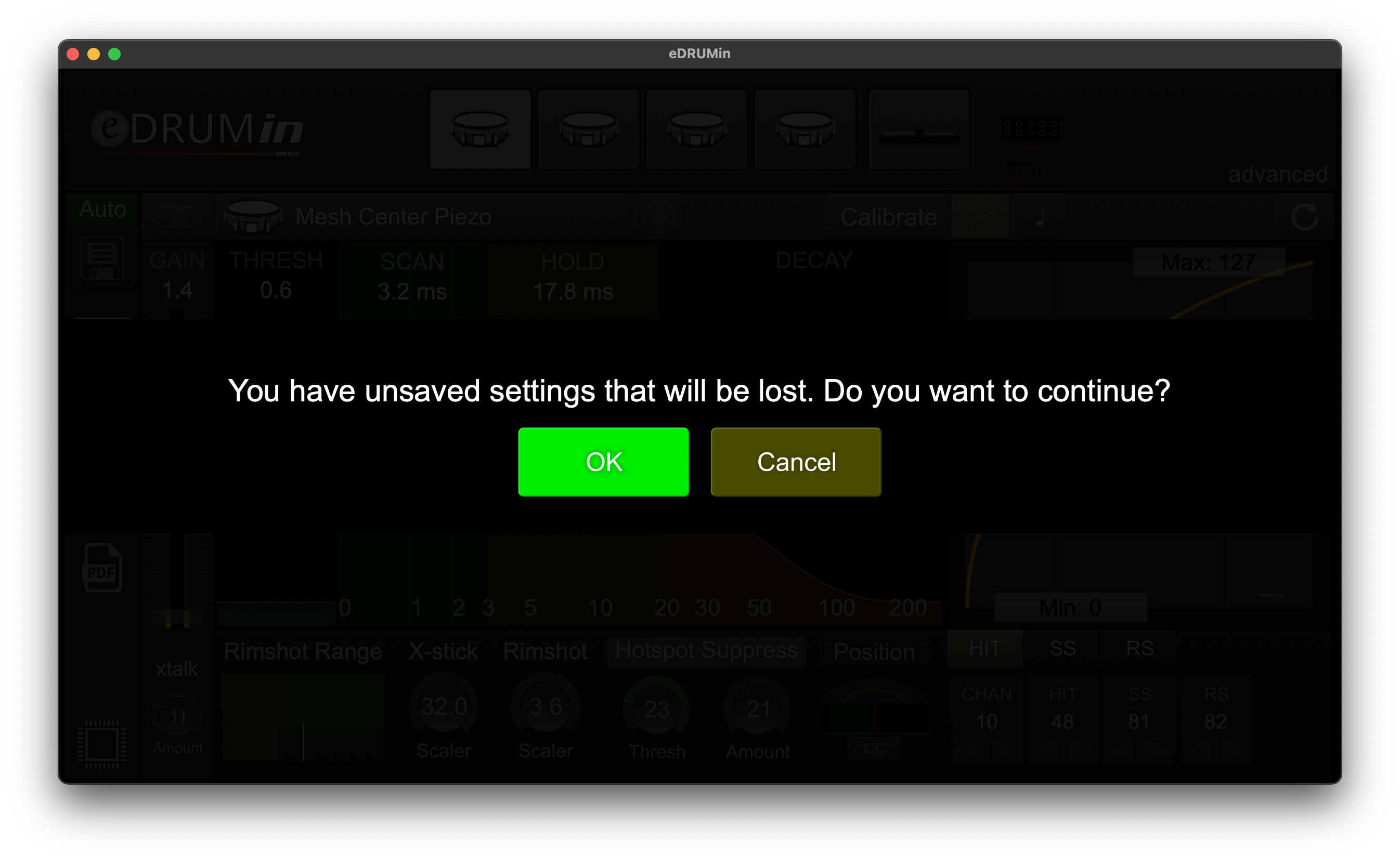

Updating the ED10 went without a hitch (bypassing the hub, of course) but upon trying to update the ED4, I got this screen. Clicking OK did nothing, clicking Cancel crashed the app. After relaunching the app, it appeared that the ED4 got updated anyway (that is, I'm not seeing the red bang.) Crash report attached.

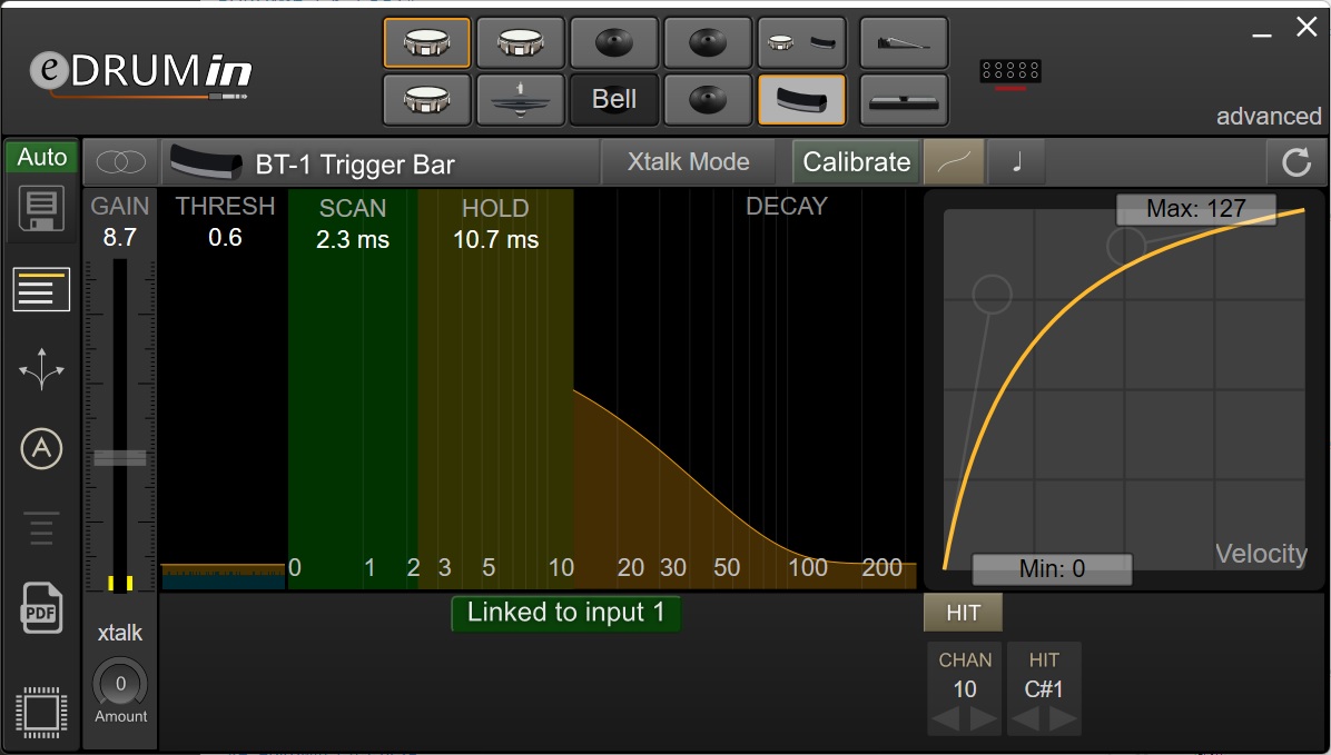

This is the threshold that is too low.
Can I see your settings for the BT-1?
Thanks for clarifying. I'd set it to 0.6 as I get no false triggering until 0.4 - snare is on a DW9000 so is pretty well isolated. I felt 0.6 would be enough headroom whilst retaining decent sensitivity to low velocity hits. I'll try adjusting it though and report back.
Here're my BT-1 settings (attached to snare rim)...
