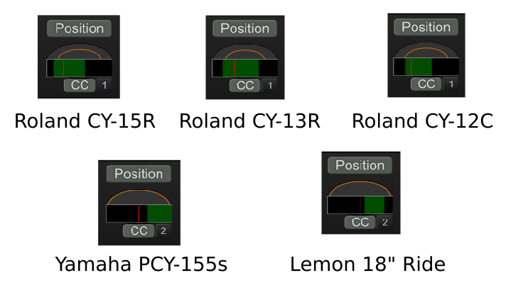

Changes in Build 1
  • Two separate PS algorithms for cymbals (1) For Roland and (2) For Yamaha and Lemon 18" Ride
  • Fixed Bell Sense issue with CY-13 algorithm and improved performance in general.
