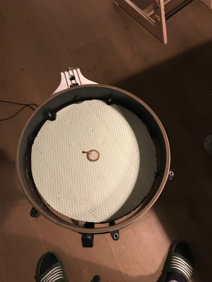

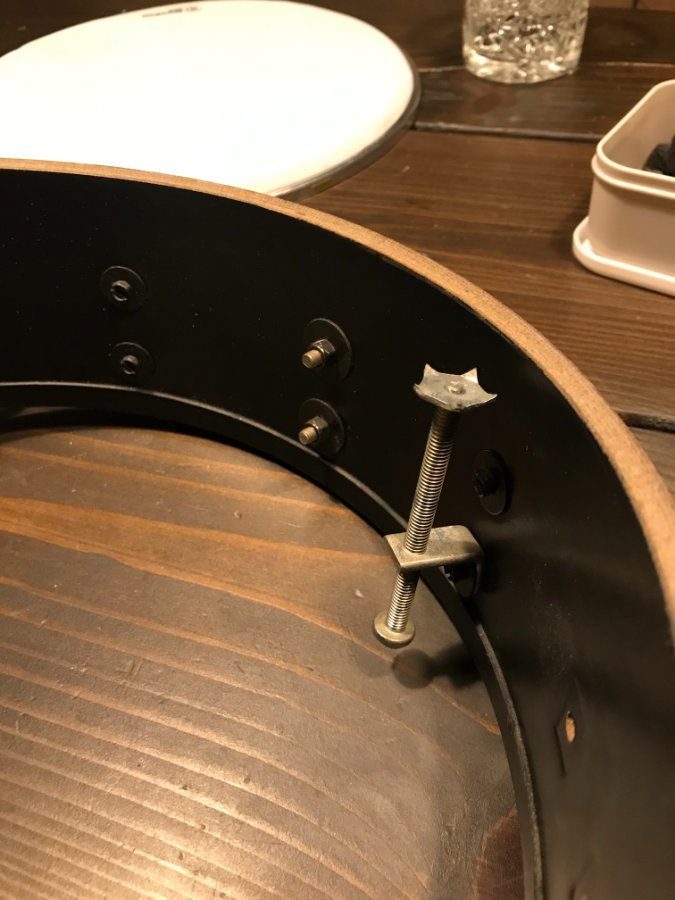

Thanks again for all the feedback, I'm still researching and preparing to do a build, but with more understanding my confidence is growing to the point where I think I'm up for it. I made my very first proof of concept trigger 2 days ago in a PD-100 shell, where i built a simple adjustable platform, connected a single sensor piezo with some foam on it, all from stuff that I had laying around the house, and it worked first time! giant hotspot etc, but it was something
