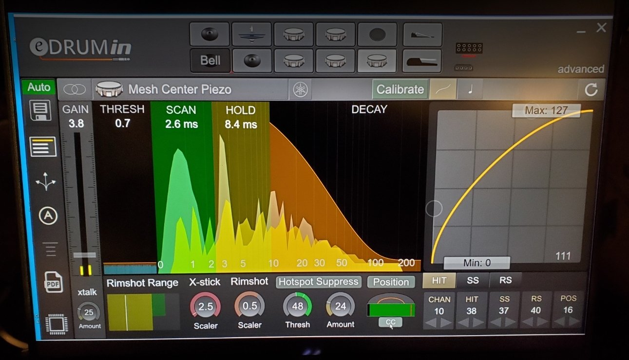

Hi I'm on version 1.6 older version of FW on eDrumin10 and I'm having an issue with the snare where while hitting the head in the center of the PDX-10 at some points during play it will start to register these hits as if they were toward the edge of the pad. It will get stuck like this for a bit with several more hits in the center generating a sound as if you're hitting the edges of the pad. After a little bit of this behavior then the pad starts to provide the correct sounds again, seems to right itself again.
I've messed with the settings, turned hotspot suppression off, turned off positional sensing as well, but it doesn't do anything to help the problem, so wanted to write here to see if any way to fix it. Here's a pic of my current settings for the pad.
Thanks in advance for any help.

That's pretty old firmware and a lot has changed since then, including lots of bug fixes and improved functionality. Are you setup in a DAW environment?

I assume the problem goes away if you completely disable possitional sensing and restart SD3?

I'm guessing that some other pad has positional sensing on and is sending CC16. Check your other inputs and the SD3 MIDI log to confirm.
I've seen it does go away if I hit the first tom then go back to the snare, maybe that's causing it. I'll have to check like you're saying, thank you
