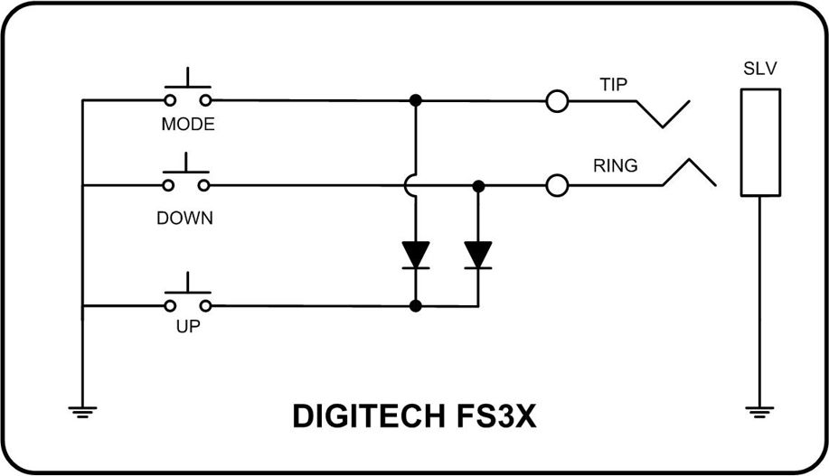

Anyone have an existing easy diagram of how these 2 switch pedals are wired? I'd like to connect three momentary buttons to one input.

I just got my Midi Expression interface to use it with the TC Switch 3. I upgraded to the latest 2.9.3.10 firmware and tried it out. Unfortunately it seems not to work for me - if I select the 3 button footswitch, the press of the 3rd switch is registered as presses switch 1 & 2 together...

I don't actually own the TC-3, but rather made the circuit myself. Looking more closely at the schematic for that footswitch I see that the forward voltage drop of those diode is 1.1V, but the diode's I used during testing were the typical 0.7V. I'll order some new diodes and make the needed adjustments.
