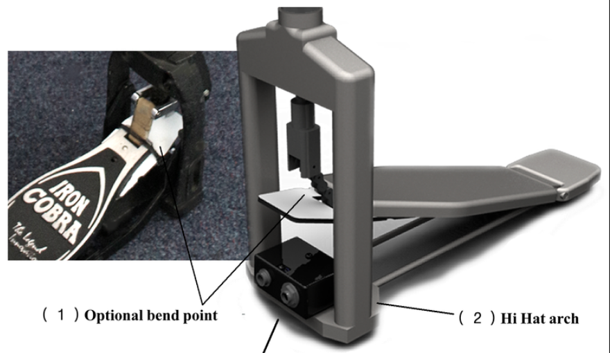

The Drone trigger optical driver/sensor I have is set up on the base of my hi hat. The reflector is attached to the hi hat footboard.
Here's an image of the configuration from the seller:
Screenshot 2023-11-13 at 12.10.19 AM.png (423.74 KiB) Viewed 12590 times
So far I've only connected it to my Pearl Mimic Pro and have had no issues with ambient light interference. It was extremely easy to set up. I happened to have the Iron Cobra hi hat that KitToys (aka Drone) used in his own setup. The offset for the reflector plate was perfect. I'm going to to connect it to my eDRUMin tomorrow. It seems to me either the optical sensor or a hall effect sensor would be about equivalent in performance, but the hall effect sensor does not require aux power which the optical sensor does to power the light source. So it's simpler. I think it's worth my trying a hall effect sensor for its simplicity, but I really appreciated the plug-and-play of the Drone optical kit i purchased on eBay.

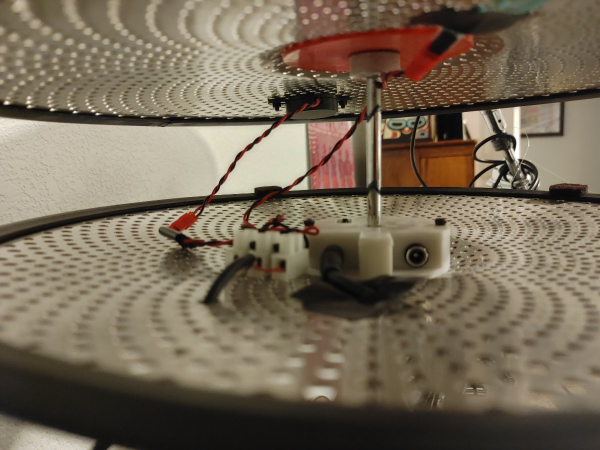

I've been rocking a tcrt5000 sensor controller for a couple years now. It's a "hockey puck" design that I stick in between my hats. It runs power off of the edrumin. It's awesome.

Here are pics of my "hockey puck". I know one fellowber.ive shared this with found it successfull. Rob, I'd be happy to send you my spare for some r&d feedback. This is something I've been thinking about producing but have been to lazy/afraid to pursue. It can either run off of the edrumin power or a separate dc source.

I've been looking at real world advantages/disadvantages of hall vs. optical viewed through my career experiences in electronics (retired now). I've dealt with both. In an e-drum situation, it appears to me that there's not a dimes worth of difference performance wise between the two. Optical may have the slightest disadvantage with ambient light interference and occlusion of the lens due to dirt,dust, environmental conditions, but in actuality that really is only a problem in harsh or extreme environments. Don't think anyone's going to be gigging at the astrodome on Mars any time soon. Careful packaging design can cover those issues. The other inconsequential issue is getting cables out from between the hat cymbals in an elegant manner, again, not really consequential. I think it just comes down to personal preference and/or if your pedal configuration allows for sensors to be located at the pedal instead of the hats.
Having said all that, I like your idea of commercializing your design, and I'd like to offer a suggestion. It should be possible to make your pcb design flexible enough to accommodate either a hall or optical sensor. For a hall effect version, mount a ring magnet to the plastic reflector disc under the top hat. A ring magnet will alleviate any magnet misalignment due to inevitable cymbal spin. So with minimal effort, you could cover both Hall and optical customers with essentially the same design and potentially double your sales. Just a thought....
