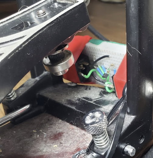

I just quickly hooked one up here. It's not pretty, but it's working fairly well, and I'm able to trigger the closed pedal notes just fine. I couldn't position the sensor quite right, but I'll make it more optimal when I get more time. The way you orient the sensor and the way the magnet moves are very important to get a linear response.
By the way, the sensor I'm using is DRV5056A1QLPGM, and it provides a lot greater voltage swing than the SS49E given the same magnetic field. The reason SS49E is listed in the manual is because the first generation of eDRUMin devices couldn't supply enough current for the DRV5056A1QLPGM. I'll experiment more with my SS49E, but I need to get some more powerful magnets. I'll also update the recommended sensor in the manual.

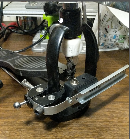

In my design, also using the SS49E I have the project box mounted to the rear of the pedal rather than under. I mounted a pair of hard drive magnets (they look like boomerangs) south side down to the end of the rod. To give an idea of how strong these magnets are - they're hard to pry off a steel door. The magnet travels straight down until it's in front of the sensor. Because of the sensor being inside the project box it can only get to within 3mm of the sensor. The sensor is mounted vertically with the beveled side towards the magnet:
Here's what it looks like on the hi-hat stand. I used a Small Rig clamp to affix the project box to the stirrup. I trimmed the metal strip after this photo was taken. The magnet holds itself to the end of the rod and I used the white material (InstaMorph plastic) to keep it aligned.
