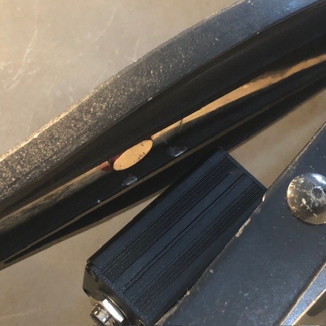

Can you post a pic of your design?

As requested, here are the basic details of my build:
The sensor is an SS49E flush mounted on surface of the box. 1/4" jack in end of box. Neodymium magnet mounted on back side of pedal, Very simple, very solid.

Are you trying to power the SS49E directly from the eDRUMin hihat pedal?
According to the datasheet, that sensor needs at least 4V. Also, hall effect sensors produce a voltage proportional to the magnetic field, but the way you have things setup, the magnetic field is going to drop off in a non linear fashion. I'm not sure how that's going to affect things. I'll try an hack together my own design next week and see if I can reproduce your issues.
UPDATE: That sensor should indeed work at 3.3V. The parametric data on Mouser was incorrect.
