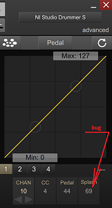

Reporting bug in build 2.0.0.27.
The HiHat user preset is loaded incorrectly, it has one number lower.
Note plays correctly.
- user_preset_1.png (24.66 KiB) Viewed 2408 times
- user_preset_2.png (22.75 KiB) Viewed 2408 times
Re: eDRUMin version 2 BETA
Fixed for the next build. Thank-you.andurillek wrote: ↑Sun Mar 13, 2022 3:16 pmReporting bug in build 2.0.0.27.

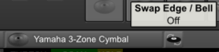

The original Yamaha drum map is misspelled as "Yahama".
I also want to ask...
I use a 3-zone cymbal Millenium (stereo imput), I used pad type Yamaha 3-Zone Cymbal.
Unfortunately, the edge and the bell are reversed.
I want to ask if it would be possible to create a bell and edge rotation button?
Or if it would be possible to create a 3-Zone Cymbal Millennium ... or other?
Thank you very much in advance.
I'll make a swap edge / bell button. UPDATE: Will be available in build 31.
