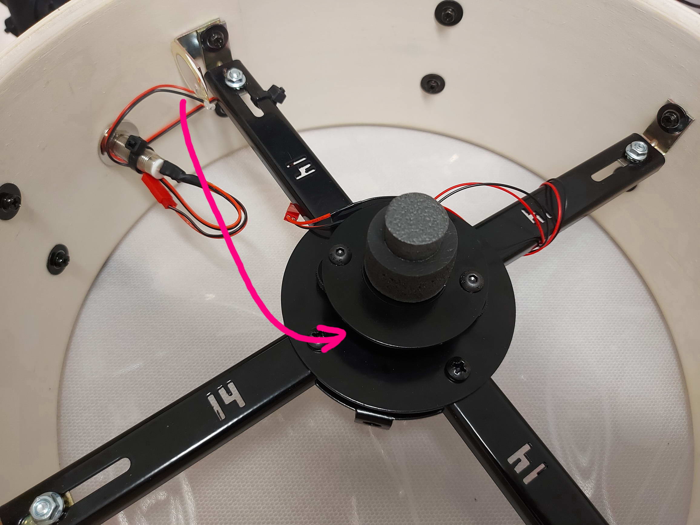

Uhh, sorry .. I recognized this thread in the eDrum Workshop review ...
So, for solving the Jobeky snare problem I will definitely grab a softer cone.
The Jobeky ones are quite dense/hard.
Thanks for your efforts!

Hi!
I found this:
https://www.682drums.eu/en/diy-drum-triggers/
And, I think they will ship only to Germany:
https://www.drum-doktor.de/etrigger-sets
I ordered a black and an blue one...

mprinz
Posts: 403
Re: My Pad is too hot!
Post by mprinz »
That's true!
Detlef, the guy from drum-doktor.de replied already.
That's exactly the reason why he developed some 2-component super-soft cones. :o
So I am looking forward to get those ...
He seems to work with Jazz e-drummers.
I will report about the result!

mprinz
Posts: 403
Post by mprinz »
damn!
Here is the thing:
Today I changed the cone . I put it on the stage without decoupling cushion. The transients look good but I still got these 127 velocities...
Just before kicking the whole s###t through the wall, I clicked on "reset input" and everthing was fine with regard to the velocities hot spotting etc.
WHAT!? I was quite down ... I used a gain of 1.1/1.2 and I'm fine.
But side stick, rimshot and pos sense triggering was a mess.
So, again - head off - and placed a cushion (some left overs from the Jobeky surgery) below the head piezo and it is more or less usable.
I have tree different trigger cones here from https://www.drum-doktor.de/etrigger-sets and now used a blue PRO. Which I had to shorten a bit unfortunately. But I think, that doesn't matter.
Anyway, since I actually have no idea if all that was just a software/electronic/something issue, I won't blame Jobeky for anything.
But it's a fact that - when you squeeze the drum-doktor.de cones, they are back to their shape way faster than the Jobeky foam rod.
Also the physics are still valid... I would guess, I have just 1/4 of "sensor" area than with the Jobeky rod... leading to 4 times less energy traveling to the piezo.
Ok now it's "usable" but I have quite a large yellow area in the rimshot range display.
And I get a lot of side stick triggers when hitting the edge of the head.
I would guess, that the rim piezo is now the issue. It's mounted vertical onto a metal angle on the shell. Since the cheap Millenium drum pads have a center mounted rim trigger below the properly decoupled head piezo and are working fine, I will also install it below the head trigger "stage".
And that's my last idea ... to get a fancy pos sense out of that thing.
