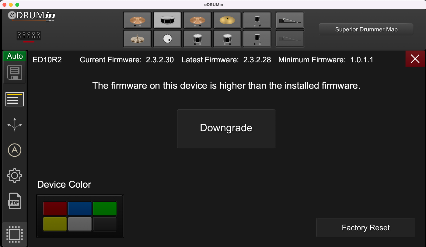

Okay. Can you please post screenshots for your setting in eDRUMin for your kick and ride? Also, what firmware version are you using?

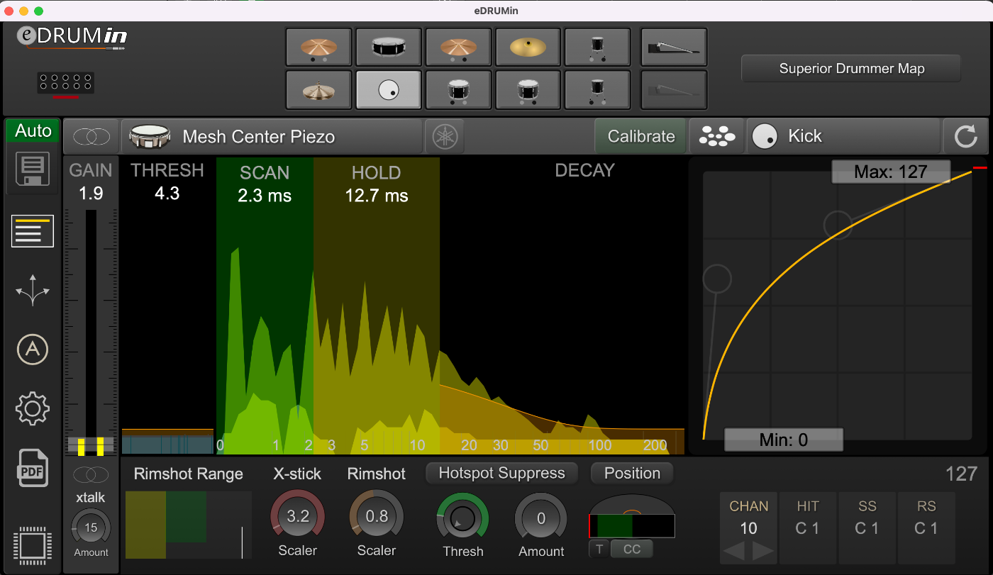

Here it is
Screenshot 2025-03-05 at 08.41.45.png (269.57 KiB) Viewed 3702 times
Screenshot 2025-03-05 at 08.41.25.png (302.27 KiB) Viewed 3702 times
Screenshot 2025-03-05 at 08.41.12.png (179.92 KiB) Viewed 3702 times
Re: Kick eats ride hits
So if you turn the xtalk control for the ride all the way down, it still get's 'eaten'? What make of cymbal is that? The amount of gain you are using is really high--that's what I might expect for a Yamaha cymbal.

Nope, stock Alesis cymbals.
You asked me to turn xcross control all the way down, well... how to say that I'm the kind of guy very confortable with gear, technology and IT and I already tested almost everything to tackle this issue... but turning down to 0 this xcross knob. And it is a fact that neither my ride nor crash cymbals miss a single hit now.
Thank you so much!!!!!
