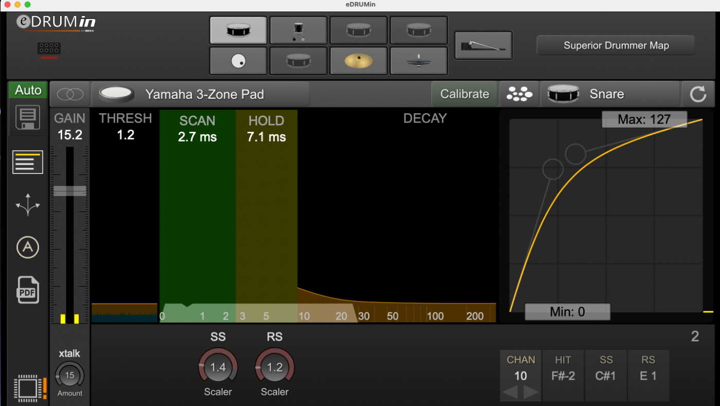

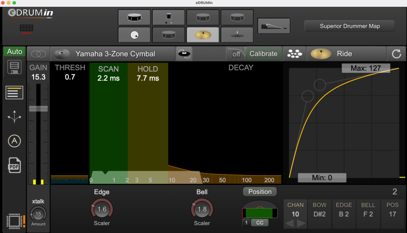

Thank you for the quick response Rob! This issue is persisting after verifying that I was running version 2.3.0.8 as well as reinstalling the software. I updated to the newest version 2.3.0.9 today and am still having the issue. The system I am running on is an older MacBook Pro with macOS Big Sur Version 11.7.9. I have also attached screenshots of the eDRUMin settings for the snare and cymbal.
Screen Shot 2023-09-26 at 8.49.02 PM.png (962.99 KiB) Viewed 6284 times
Screen Shot 2023-09-26 at 8.47.53 PM.png (948.18 KiB) Viewed 6284 times
Posts: 4819
Re: Yamaha 3-zone pads only triggering 2 zones
Click that icon next to the orange exclamation mark on the bottom left hand side of the UI.
WB00
Posts: 3
Joined: Sat Sep 16, 2023 12:49 am
Post by WB00 »
Well, it looks like I had updated the software but not the unit itself! Clicked on the icon and updated the unit and now everything is working great! Thanks Rob!
