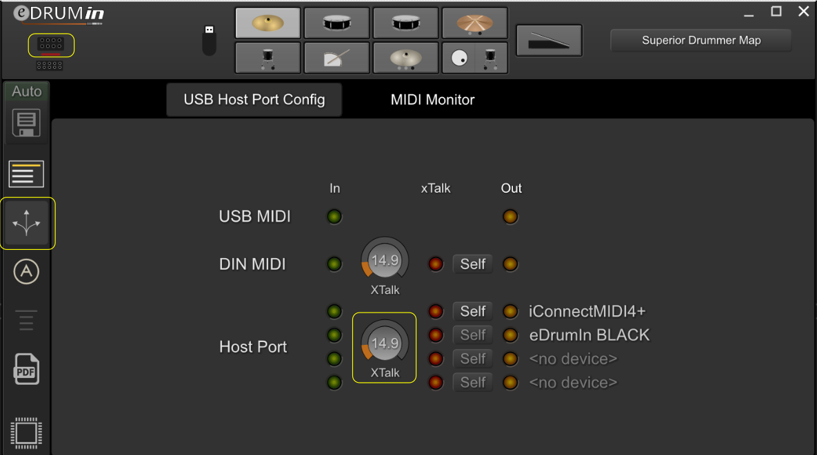

2. I see that your hihat cymbal in connected to one device, and the hihat controller is connected to the other. You should move your hihat controller to the same device as your hihat cymbal so that the two can properly communicate.
3. Go the xTalk setting for the host port and turn it down. That's probably what's muting your kick.
Host Port Crosstalk Cancellation

Thanks, Rob. I've set it up as a rubber pad for now. It had changed itself to being Floor Tom 3 somehow and had an exclamation mark on it -not sure if that is related. As for the hihat and kick problem, I haven't had a chance to check that yet as I just changed my hihats for the ATV aD-H14's and I can't get them working but I posted that in the Technical Support subforum.
