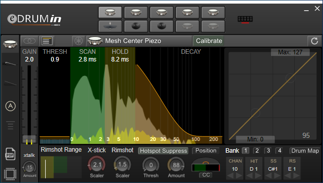

The ED10 has a lot more headroom than the ED4, so that's surprising. Can you attach a screenshot of your settings?

The hot spot is 0 but I tried all possible values heheRob wrote:The ED10 has a lot more headroom than the ED4, so that's surprising. Can you attach a screenshot of your settings?
- settings.png (68.64 KiB) Viewed 1753 times
Re: Hotspot not detected
How hard was that hit?
Start with the Amount control at 0 and first adjust the thresh control. After you have set the thresh control properly, start increasing the Amount control.
Rather unintuitively, if the amount control is set too high, the hotspot suppression will stop processing. I'll try to improve this behavior in version 1.3.2.

Not that hard.Rob wrote:How hard was that hit?
I tried a lot of cone positions tonight again. Almost not touching to a lot. The amount at 0 help but not that much.
Still the threshold sense only when I it very sofly. If I hit normally near the center it spike at 127.
I even recalibrated hitting really really hard and it's still 127 near the middle. (at least 3po radius) even when the hot spot is detected (1/10 hits)
Ya, the signal is just way too hot and so it's clipping, and as a result the waveform that needs to be analyzed is missing information.
I don't know what else to tell you. You could use a softer come, a smaller piezo, or add a potentiometer to attenuate the signal.

Ok after more experiments the sponge is not better and it does the same issue.
So I bought a pot, set the value to the min, and put the gain not really high. So the transient doesn't become too hot and I can see all of it in the screen. (did different gain level too)
Tried another time different cone positions.
The HSS still doesn't show any threshold. I'm starting to be really discouraged. It's unplayable because in the middle it's always 127. I don't understand why it doesn't detect anything.
