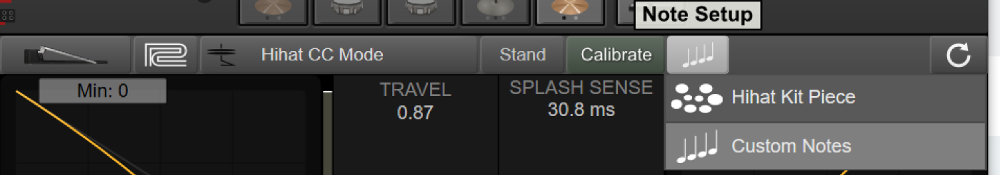

BTW, you don't need to the use the eDRUMin drum maps for the hihat. You can configure the eDRUMin to use whatever notes you want by setting the pedal to 'Custom Notes'.
Changing the setting for the pedal will make the notes for the hihat cymbal and pedal editable.

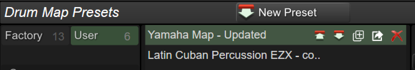

Can you give the attached map a try. You can download the .edp file and import it by dragging it onto the preset manager. It'll then show up in your user drum maps like in the screenshot below. Don't forget to double click to load it. I think for best results, you want to switch back to 'Hihat Level Mode' with this map.
Yamaha_Map__Updated.edp
(572 Bytes) Downloaded 584 times

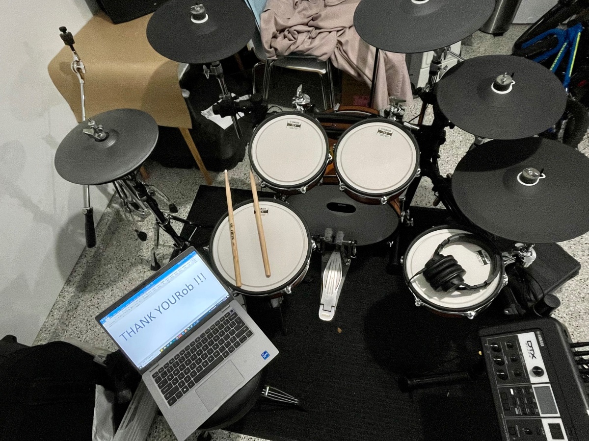

This map works like a charm! :D
- splash ok
- open/close dynamics ok
- edge sound ok
This EDrumin is amazing!!!I just recommend it for my friends.
Thank you and Merry Christmas
Marcos
