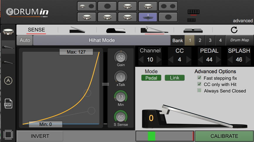

The VH-12 is a bit of an oddball in terms of hihat controllers and does not play well with eDRUMin without making some adjustments in the control application.
1. From the pedal editor, click on the hihat icon to disable pedal sense.
2. Change the polarity control from 'auto' to 'Roland'.
3. Calibrate, and use the mouse to manually adjust the calibration range so that the green bar looks something like what is shown below:
Getting the VH-12 to work properly with eDRUMin

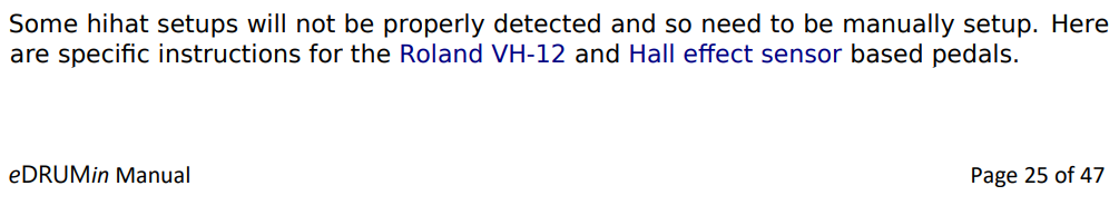

First, the PDF manual for eDRUMin10 show a VH12 link, but it does not link when hovered on like a link so I am here hoping to find answers here that might help others as well.

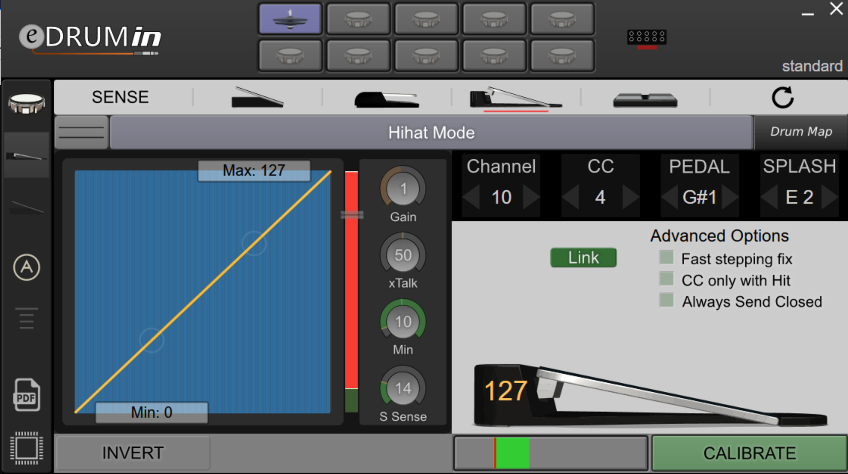

My calibration looks different than the video and the first post above. My red line moves all the way to the right when I release. The image below is a screen shot while pressing the pedal. I can't seem to get edge notes either, just bow, only closed F#1.
Lastly, is it me or is the midi map off? Isn't Roland similar to General MIDI, but the HH is:
44 hh pedal (G#1) [assuming closed chick sample sound)
46 bow open (A#1) [assuming open ride-like sample sound]
42 hh closed (F#1) [assuming closed tight sample sound; eDRUMin10 is only detecting this for me, I would think I would get only A#1 until closed]
26 hh edge open (D0) [assuming barely/slightly open hh sample sound]
I don't see "E2 Splash" per eDRUMin Control...? [I would think a splash would be activated upon quick chick and release to get A#1 ride-like sound]
I can move samples around easy enough in Ableton, but I usually use TD25/50 note map. ^tom 4 might be different than Roland or GMIDI, and per1,2,3, but rest should be correct.
Thoughts?

I fixed the link in the manual. Thanks.Martin wrote:First, the PDF manual for eDRUMin10 show a VH12 link, but it does not link when hovered on like a link so I am here hoping to find answers here that might help others as well.
Here are some note:
Currently, eDRUMin does not change the HH notes it sends based on the position of the hihat pedal. For example, if the trigger input for your hihat is set to send note 46 when you strike the bow, it will always send note 46. This isn't how Roland does things (as I'm sure you are aware) and so you might see troubles if trying to trigger on a Roland module. However, VSTs like Superior Drummer, BFD, and Addictive Drums will not have this problem assuming you are using their default presets. They use CC4 to determine what level of openness and ultimately what note to play.
Looking at your screenshot, I can see that you need to increase the gain control to about 30. If you don't, the 'chck' note is not going to have enough velocity to properly choke the hihat cymbal.
I understand that setting up a VH-12 is a bit tedious, but I assure you will get good results. Hopefully in a couple months' time I will have presets for hihat controllers, and that will take out a lot of the steps in settings things up.

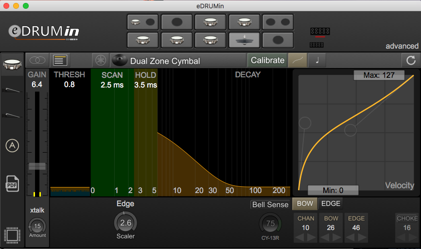

For the VH-12 cymbal, just load the preset for the VH-13 and that will likely work very well. Can you attaching a screenshot for your VH-12 cymbal trigger settings?Martin wrote:I can't seem to get separate bow and edge notes on the hh cymbal, just bow. The bow does seem to have a second sound, but its not triggering another note, or the edge at all from what I can see in the Controller and in Ableton.

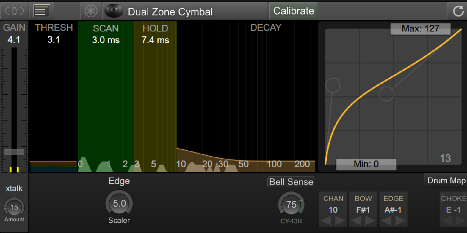

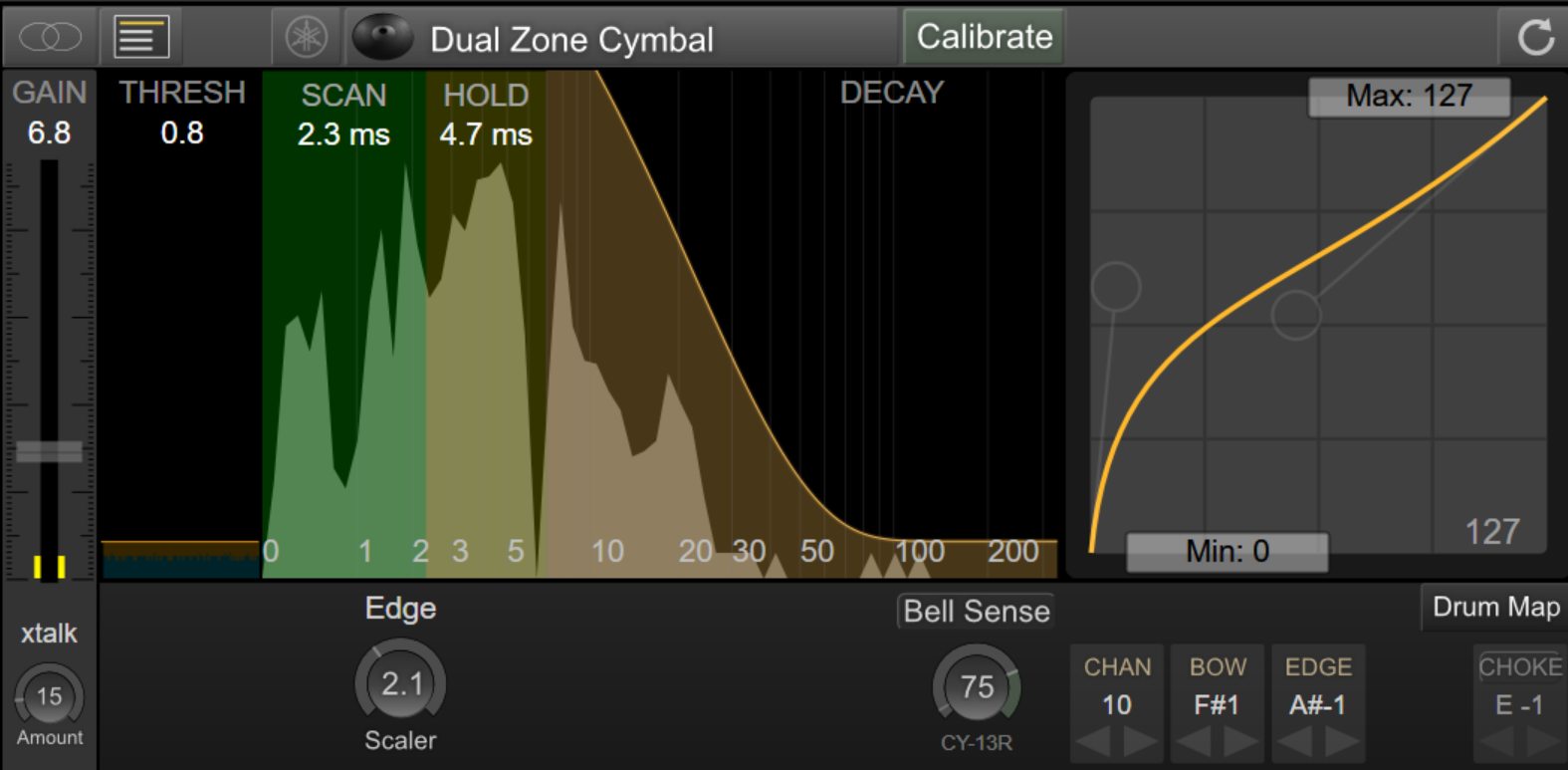

Moved gain to 30, x talk 50, it's better, but still getting random bow samples. Seems 90% fine, mostly get chick/close pedal note. On occasion a bow note, which seems to come if I go slow, or soft, or soft and slow if not closing from fully opened position, and also on fast closure if not from fully opened. On fast closure from fully opened it seems fine enough.
Starting to wonder if my hh cymbal is bunk, but want to rule out settings first.
cymbal settings, vh13 after calibration:
bow: edge: Sounds like rapid choppy static if I hit edge, but only bow note registers, no edge note. The note on clean bow strike is clean.
in action on closed edge:

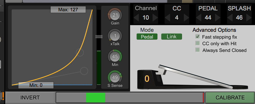

I've managed to get the VH-12 working well. Attached are my foot and pad settings - I'm interfacing it to a TD-20. Can't guarantee my settings will be applicable but hopefully maybe(?)
Note that the VH-12 manual states (on page 9) that the optimal gap between the upper and lower pads is 10mm (3/8"). I had a very hard time getting the basic 'pedal' to trigger every time, and 'splash' to work at all until I increased the gap to 1/2", to give more force to the basic foot down 'clomp' motion. Made a big difference after this adjustment - it might be better with more gap. Still adjusting things but it's working well.
Hope this helps. It's not 'perfect' but I'm pretty happy with it. Not sure that the Fast Stepping fix or CConly on the pedal work - I'm still randomly trying out things, and sometimes leave a few things engaged that maybe don't make a difference.
And I'm happy to report that I have two eDRUMin 10's working with one TD-20 and one TD-10 (both expanded) and it's going well - like 24 Roland pad type triggers (ok one old Yamaha cymbal too) and all responding really well with -minimal- crosstalk. Still some tweaking to do, i.e. I'm not totally happy with the PD-125 snare/attached BT-1 combo yet, but it's really close.
Next hook-up phase is SD3. I wanted to get the Roland stuff working well first, and with the eDRUMin it is much better than only Roland.

- 1-8 HH cym.png (156.51 KiB) Viewed 11938 times
- 1-8 HH footped.png (153.09 KiB) Viewed 11938 times
