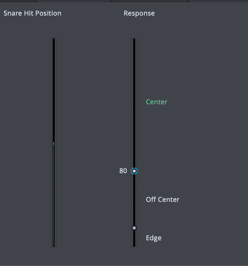

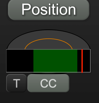

I'm looking for some help in getting this working with a Drum-Tec Pro Snare and Superior Drummer 3.
I'm having a bit of trouble getting relatively consistent readings when trying to set the CC zone in the positional sensing graphic in the edrumin software i.e.
03-10-2025, 15-05-03.png (27.52 KiB) Viewed 2255 times
I've settled on the above, but even when playing the drum, no matter what I seem to do either in the edrumin software or in the SD3 settings, I just can't seem to get a gradual progression from center to off-center to edge.
03-10-2025, 15-07-47.png (42.15 KiB) Viewed 2254 times
Does anyone have any tips in terms of hardware/software adjustments that I could play around with?
Thanks in advance.

Re: positional sensing help
Drum-tec's 3-ply 'real feel' mesh heads are noisy and are known to cause issues with positional sensing on eDRUMin. If you have a 2-ply mesh head, the issue goes away. Alternatively some users report that adding a 25k resistor in series with the piezo helps resolve the issue.
