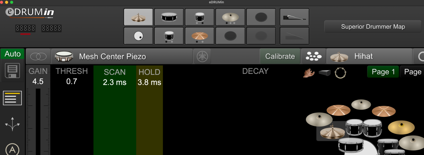

Hello Rob and everyone. I seem to have issues to make the VH10 work properly with my Edrumin 10. I plugged everything properly following the tutorial in this video https://www.youtube.com/watch?v=EnnAscbn9gU
However I seem to have a hard time linking the pedal to the hi hat, resulting obviously in cut out notes and weird response overall.

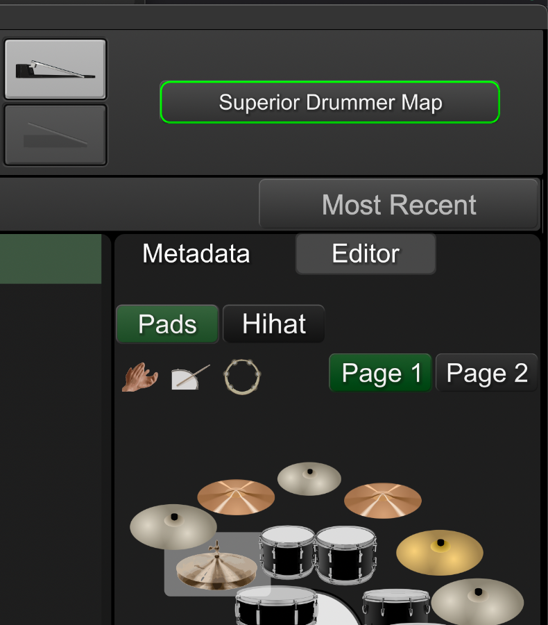

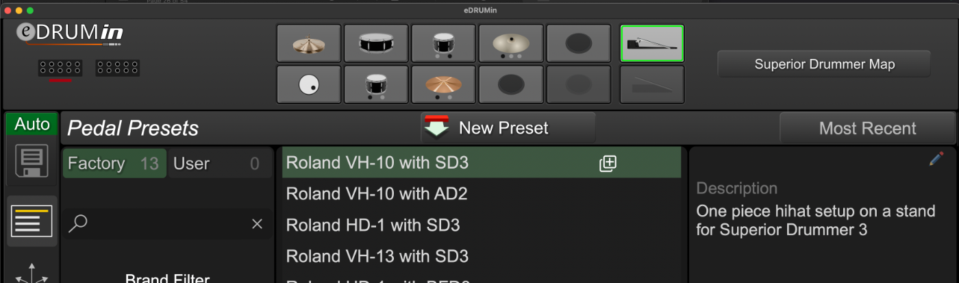

First off, I gave the pedal the SD3 map and selected the SD3 preset (see pics)
Then I calibrated it adjusting the plunger etc as specified in the video. But when I plug the Hi hat in my first channel (which I devoted to that)
I don't understand:
1. What trigger type should I assign?
trigger type.png (343.76 KiB) Viewed 4325 times
2. How do I link it to the pedal (the video shows it but I don't have this option in the software editor) to work on the X-Talk
I tried various settings including working with CC levels and open positions (pics below) but to no avail
