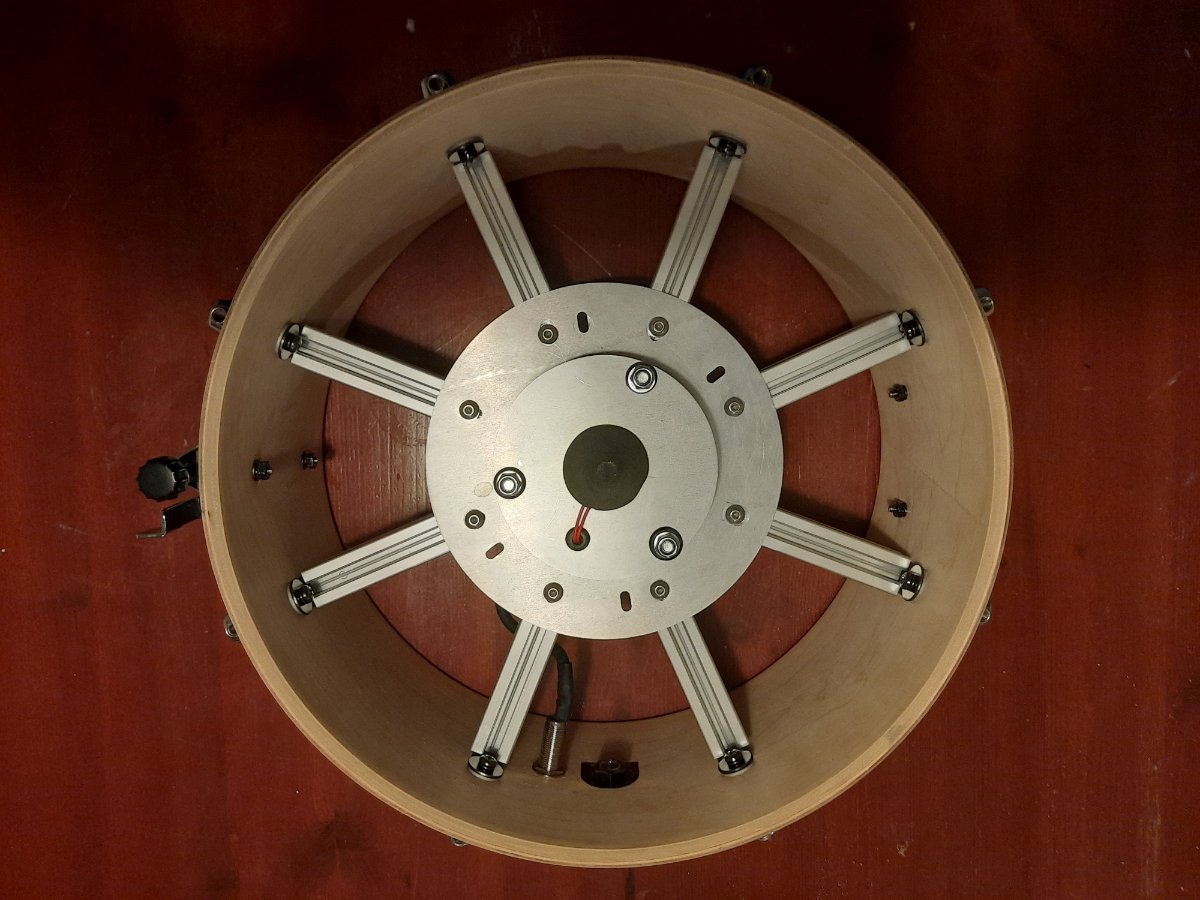

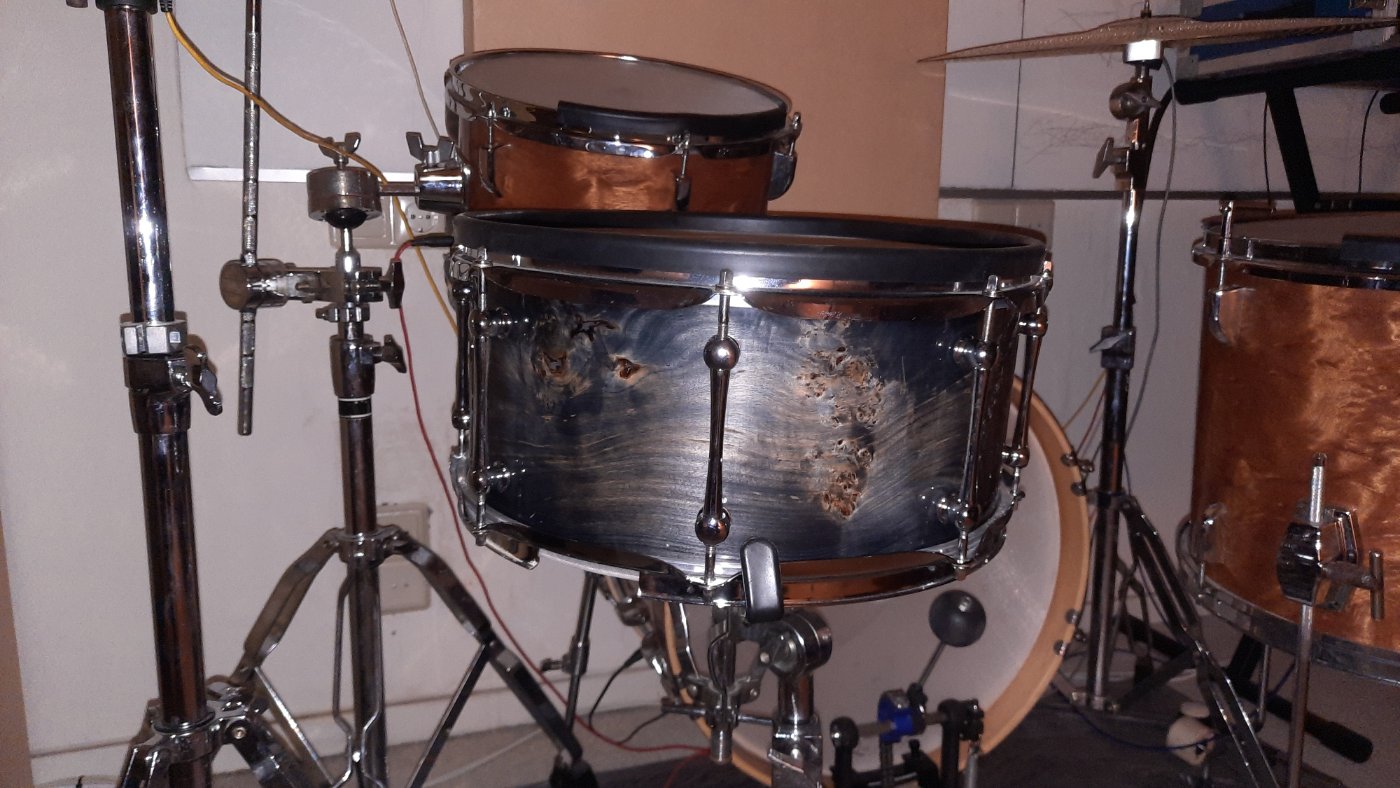

Thanks for your reply. I'm using an A2E 14x6.5 mappa burl/birch snare with drum-tec real feel mesh head and my own designed triggers. I got a Megadrum too (untill I can get me an eDrumIn10) and ironically that to be doorstopper triggers head and rimshots perfectly, but won't give me sidestick.

That snare is a thing of beauty. What brand is it? I also love your all metal construction. I've seen it posted elsewhere. Fantastic DIY job, player.
