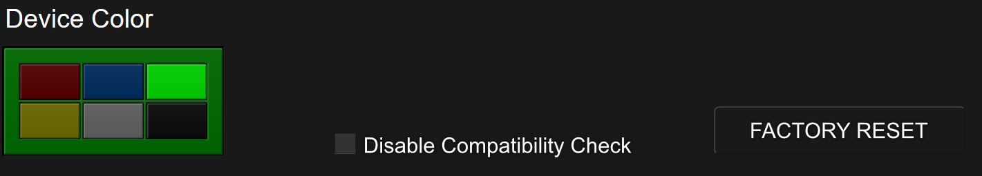

There's a way to disable the compatibility check.
1. Go to the firmware update page.
2. The checkbox in the image below is normally hidden. Alt-Shift-Click it and it'll become visible.
