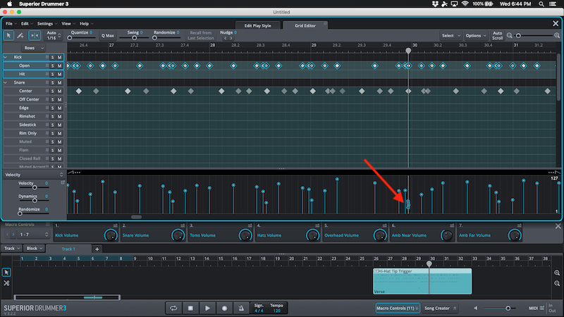

So a couple of weeks ago, I decided to move my hats, kick, snare and ride to the ED4 that's connected to the host port of my ED10. This way, I figured, if I ever wanted to take a small kit out to a gig, the ED4 would be all I need. (No gigs for the foreseeable future due to COVID but hey, I'm an optimist.)
Ever since, I have been noticing very random, weird audible artifacts, most noticeably on the kick and the snare. Every so often (but still very rarely, I must stress) there will be a hit that sounds like it is going through a "flanger" effect. It reminds me of when I accidentally had both the MIDI out and the USB going into SD3—there would be two "hits" so close together it sounded like a flanger.
Anyway, this is not that. It's also rare enough that it was nearly impossible for me to capture, until tonight. In the attached screenshot you can see that there is a completely random kick hit that gets duplicated/retriggered (I don't know what exactly is happening) at different velocities. Again, this happens on the snare as well, and I assume on the hats and the snare, but it's not nearly as obvious. It does NOT happen with triggers connected to the ED10, only triggers on the ED4 going into the ED10.

To me it looks like the the HOLD / DECAY / THRESH settings might be too aggressive and so it's just retriggering (notice the decay in the velocity of the repeated notes).

Rob wrote:To me it looks like the the HOLD / DECAY / THRESH settings might be too aggressive and so it's just retriggering (notice the decay in the velocity of the repeated notes).
That's what I thought too, but making changes there did not seem to make a difference. It also doesn't sound like a retrigger to me.

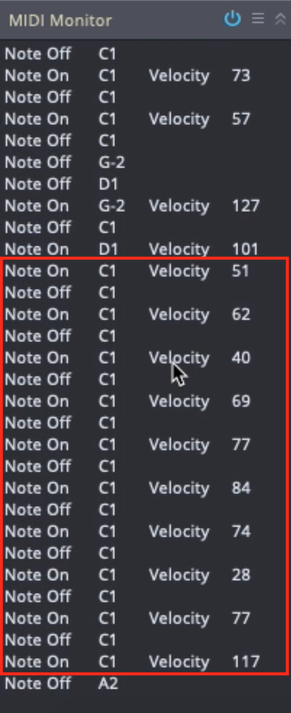

1. How many MIDI messages are there in the SD3 MIDI monitor?
2. Does the eDRUMin display the multiple hits in the Threshold monitor.
I’m just trying to determine if eDRUMin is actually sending multiple signals or is SD3 buggy?

I've been trying to find that out too. The problem is that this issue is so random, it's very hard to track down. I can be playing for 10 or 20 minutes without a problem, and then when it happens I'm either not looking at the screen, or the MIDI monitor has already scrolled past the event. I'm thinking about trying to record a video of the screen tonight to see if I can capture it that way.
I have been trying to eliminate SD3 as the problem, mostly by scaling down kit size to see if it is a memory issue, but that doesn't seem to be the case. Not sure what other approach to try there. I'm leaning towards thinking it's related to the ED4 only because that's the one major change I made recently that coincides with it.

Here's a still from a screen recording of the MIDI monitor. Not sure if it sheds any light on the situation, other than showing that there's indeed a signal coming in. All these C-1 (kickdrum) hits arrived at practically the same time.

I've also messed around with the scan/hold/decay settings some more, as it does sound reasonable for that to be the culprit, but even as I'm able to reliably cause a double trigger, and make fast hits disappear, by adjusting the Hold length and the Decay curve, none of that sounds like the weird flanger sound I'm hearing.
I also just played for about a half hour with just the ED4 (so kick, snare, hats & ride only), bypassing theED10, and was not able to reproduce the issue.

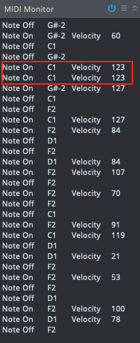

Plugged the ED4 back into the ED10 and managed to get this screen shot. Two kick hits triggering at the exact same time.
