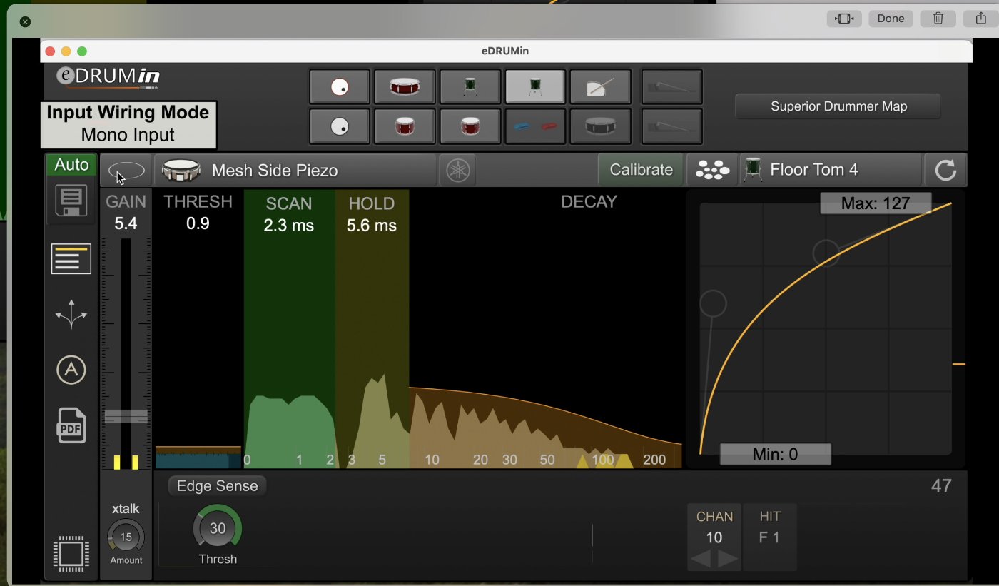

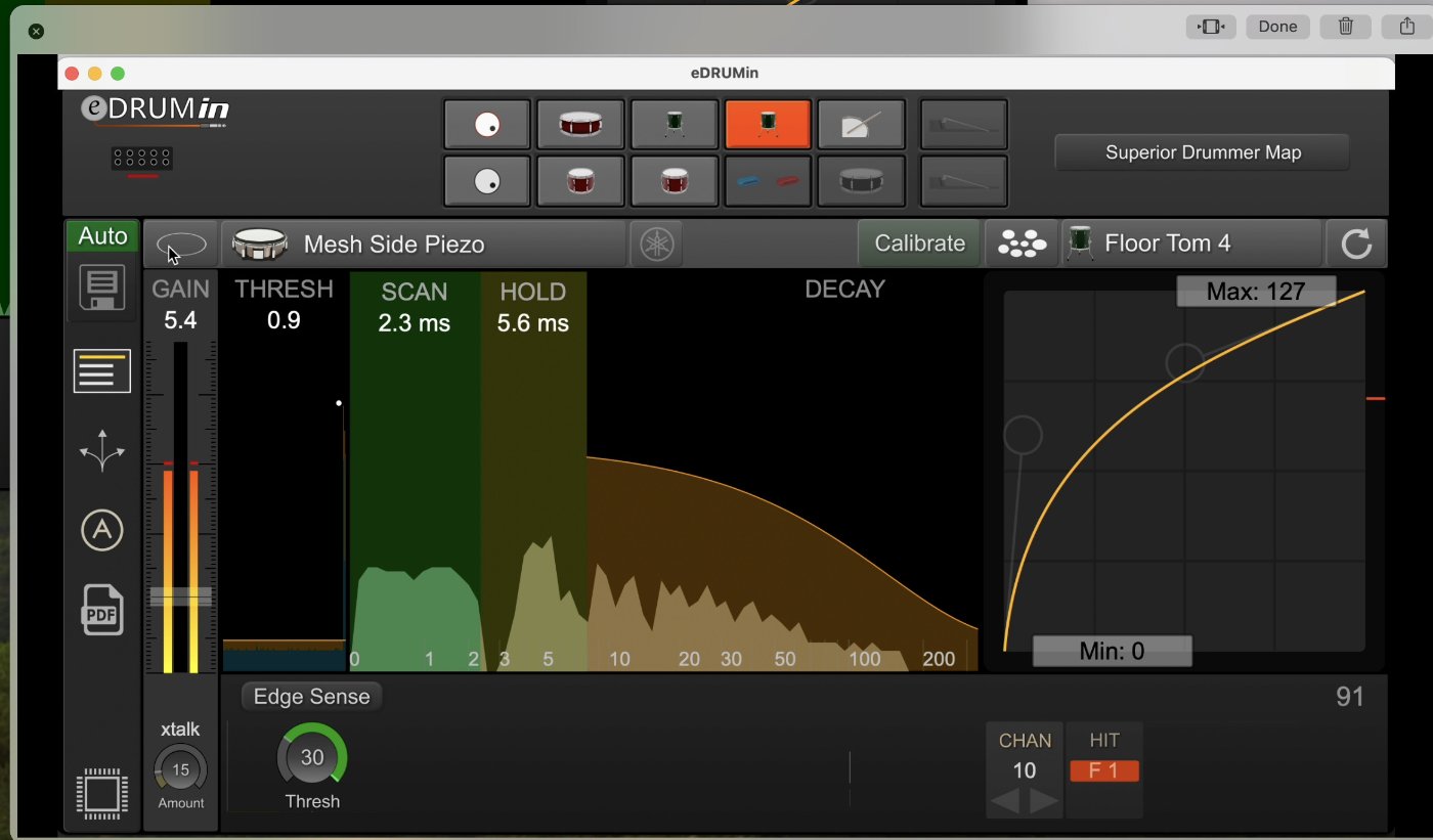

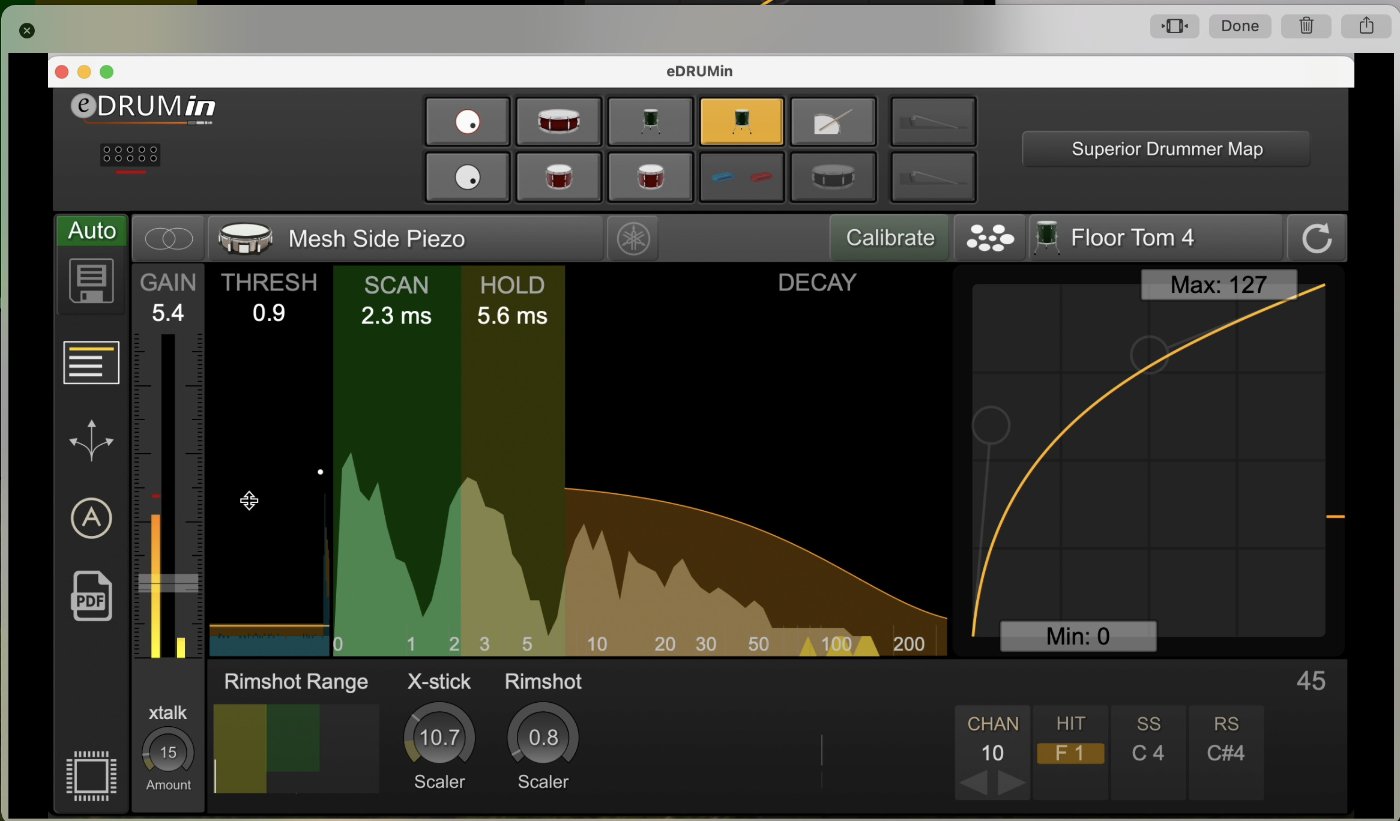

I've tried to upload mov and mp4 files and png files but get HTTP error? Could not load 4 jpegs. attached are jpegs sequence for mono input. Next reply post has for stereo input.
So for further investigating the issue: striking just one of the floor toms, but all the toms, 2 kick triggers, an older DDRum mesh pad, and a BT1 have same result:
- I have to switch the input wiring mode to stereo input to obtain the left bar (ie., mono).
Wiring connection:
piezo ceramic + to Tip; piezo brass - to shield.
I have checked each with a multimeter from the piezo back to the cable connector (side that plugs into the eDrumin input.
kindof baffled at this point.
thanks for your patience.
Ron

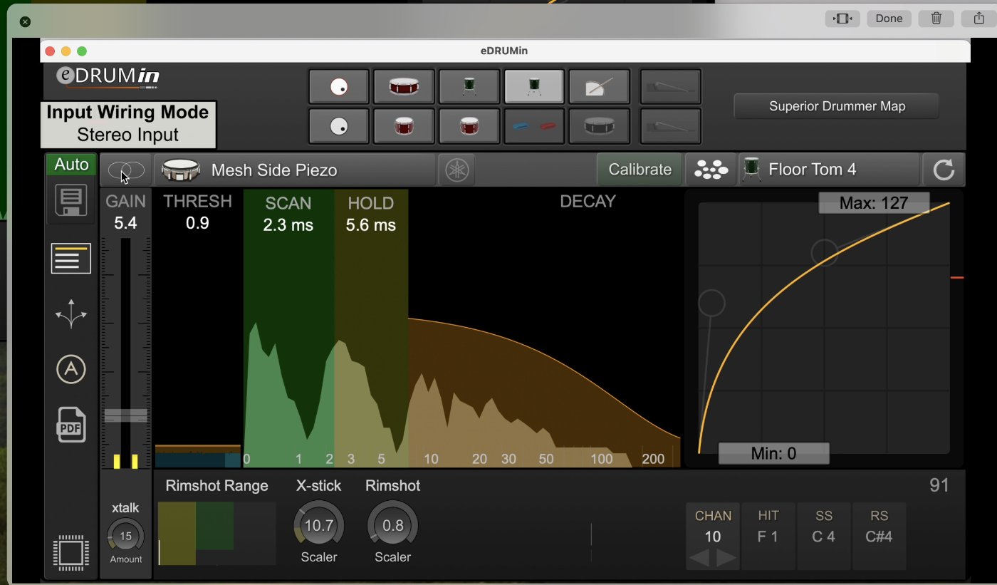

Referring to last post :
Stereo input jpeg sequence.

Nope. Everything is as it should be. Your mono ones might look like two bars, but it's actually just one with the background of the slider in the middle--notice how both sides move in unison.
