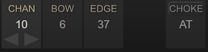

Just in case, these are my current settings. Surely I have something wrong, but I am trying to learn! :)
Thanks again for your time.
Re: Help with ideal settings for Lemon cymbal pad
The screenshot of your settings tells me you need to start by watching the video below. Let me know if the issue persists once you have the settings dialed in somewhat. Also, I would turn off positional sensing until everything else is working.
https://youtu.be/v9_w32TWKZ0
Hey Rob, Thanks so much for this. I'll give it a go tomorrow morning (or as soon as I can) and let you now how it goes. Cheers!
