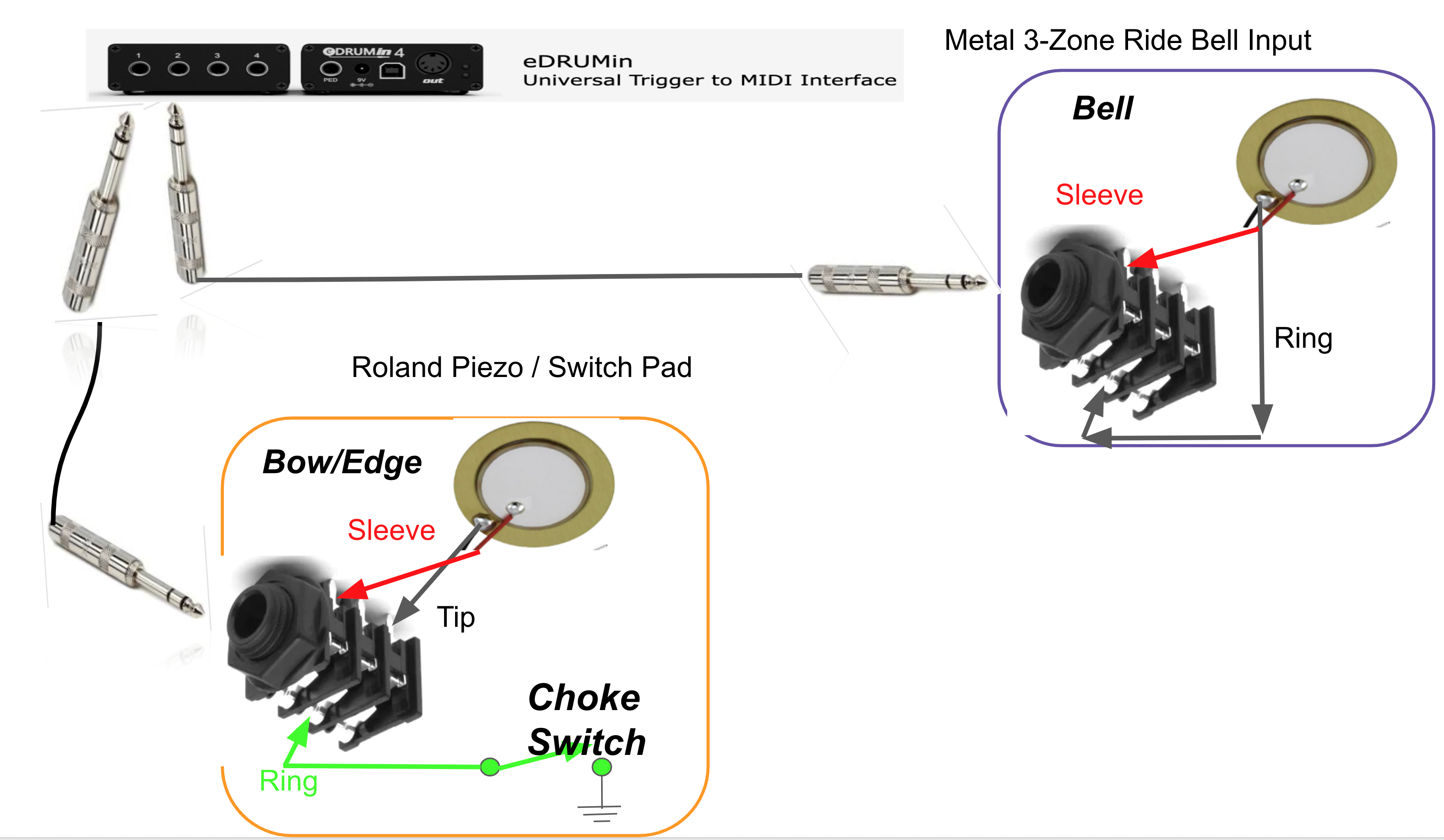

My wiring is correct (see attached) . Input mode is Stereo.

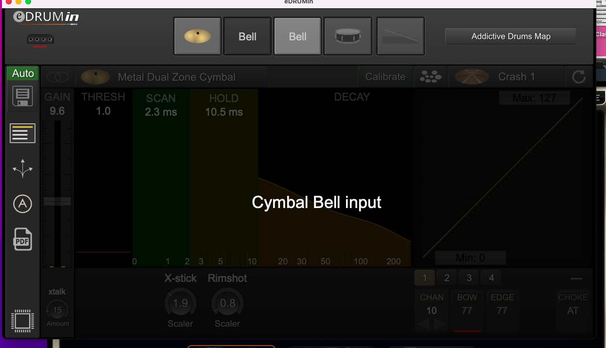

Screen Shot 2022-11-12 at 8.09.51 PM.png (1.25 MiB) Viewed 1565 times

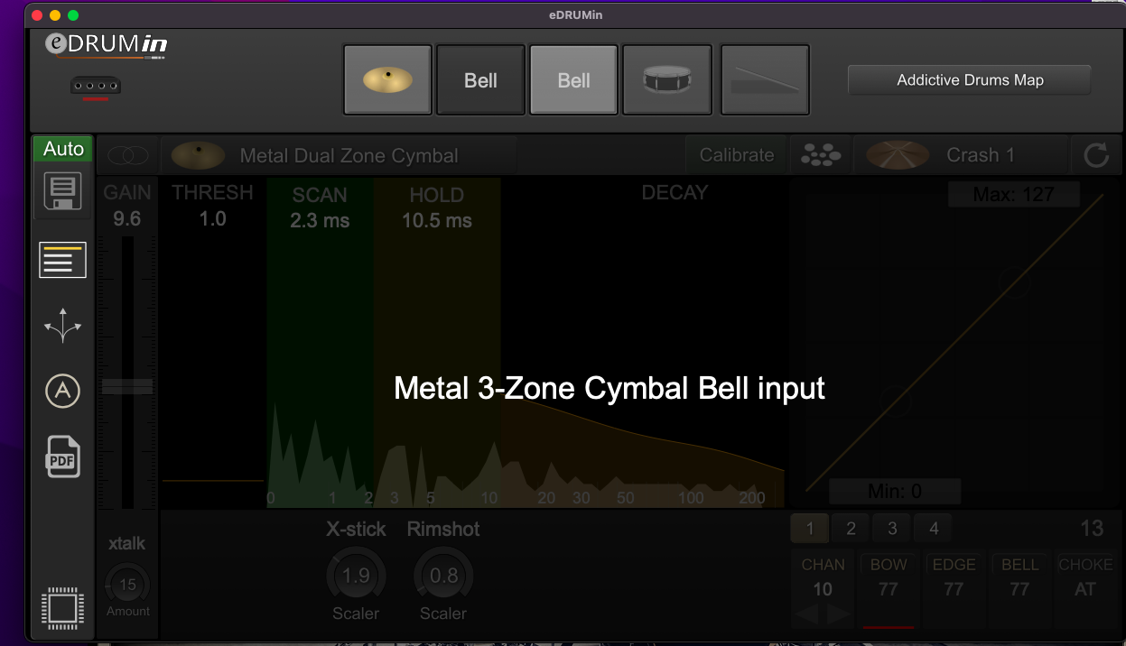

Screen Shot 2022-11-12 at 8.20.28 PM.png (202.38 KiB) Viewed 1565 times
Screen Shot 2022-11-12 at 8.21.17 PM.png (168.99 KiB) Viewed 1567 times

Everything looks in order. If I had to guess, you probably got your two connectors connected the wrong way around.

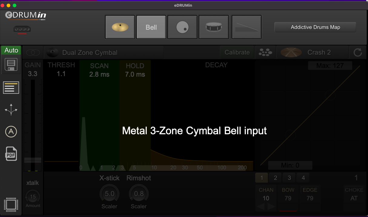

Also, I connected my 2 zone crash with choke. Checked it in y TD3. Worked fine. Plugged into edrumin input 3 and nothing. see attached screenshot. Do i have the correct pad type?
Screen Shot 2022-11-12 at 9.46.18 PM.png (207.92 KiB) Viewed 1563 times

Hi ROb,
upgraded edrumin module.
The crash is input 3. Why is the display grayed out and cannot select to calibrate and Icon is a Bell?
My piezo wiring is: ceramic - tip; brass - sleeve; choke - ring;
Since the choke is connected to the ring, is edrumin think it's the bell?
Screen Shot 2022-11-13 at 10.07.24 AM.png (205.89 KiB) Viewed 1553 times

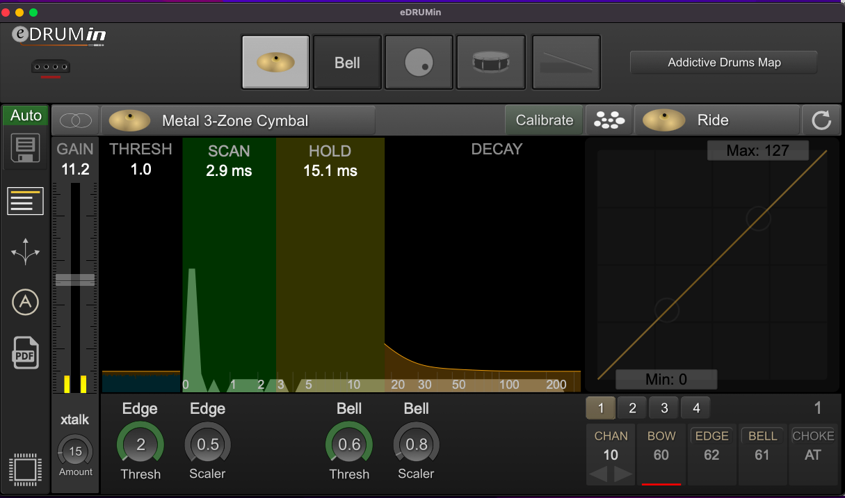

Re: Metal 3 zone Ride no response?
Hmm. Ya, it looks like both input 1 and input 2 are set to be 3-zone cymbals. I''ll need to prevent that from happening. If you set input 1 to a dual zone input, you can then set input 2 to a non 3-zone input and that should fix the issue. That's an issue that's been there since day 1. I'll work on a fix today.
UPDATE: Fixed for the next build.

Hi rob
I might be confused?
For the ride:
Input 1 -dual zone - bow
Input 2 - metal 3zone - bell
If correct then input 1 is always active , input 2 not sensed when bell is struck.

Rob, Bell is piezo for now (circuit diagram in1st post above). Later will use piezo to switch circuit or a membrane switch.
