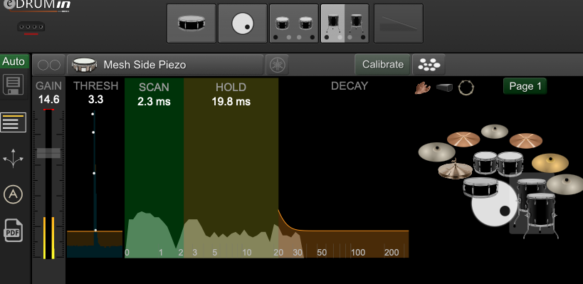

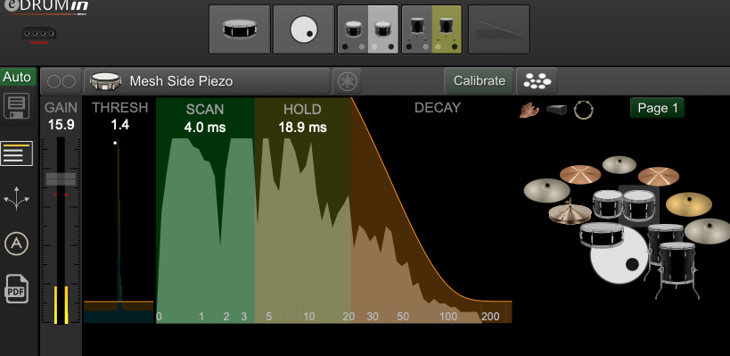

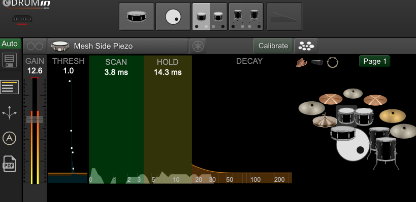

Referring to the snapshots attached: Striking the drum produces multiple points in the Threshold display area. One stroke on the drum should only produce one point for a given transient? From the attached screens, what do the multiple points on a transient represent?
Screen Shot 2022-09-15 at 6.59.17 PM.png (105.08 KiB) Viewed 688 times
Screen Shot 2022-09-15 at 6.58.29 PM.png (112.54 KiB) Viewed 688 times
Screen Shot 2022-09-15 at 6.57.58 PM.png (105.36 KiB) Viewed 688 times
Re: New guy with edrumin4 have questions?
Thanks for including screenshots. You need to relax the decay control.
