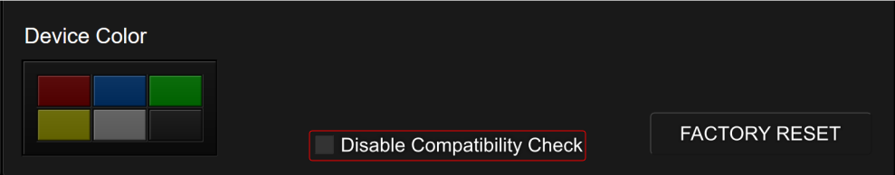

Posts: 4890
Re: Trigger Not Being Registered
option-shift-click
You might also want to move on to version 2 BETA, which is probably more stable that version 1.6 at this point. In version 2 I've relaxed the threshold for detecting compatibility issues and it would be great to hear if the changes I made resolve the issue.

Posts: 4890
Where to click
If you follow that thread, you'll see an image showing where that checkbox is. You need to option-shift-click on the checkbox for it to become visible.

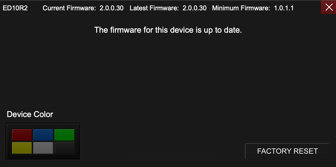

Post by seo »
@Rob thanks I was able to update to v2 but it seems like half my cymbals are still not being recognized/registered...
I am also still not sure what you mean by option shift click. I tried clicking on the screen but that check box does not pop up. Not quite sure how I'm supposed to disable the check. Has that feature been tested on the MacOS? I'm currently on Big Sur 11.6. Thanks.
Can't see the disable check
Screen Shot 2022-03-16 at 7.05.46 PM.png (179.2 KiB) Viewed 1887 times
Posts: 4890
Yes, is has been tested in macOS. You need to option-shift-click in the red rectangle. For Windows that's alt-shift-click.
