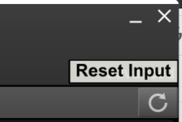

Posts: 4888
Re: Bad edrumin4 Port?
Screenshot 2021-09-22 122817.png (32.32 KiB) Viewed 517 times
