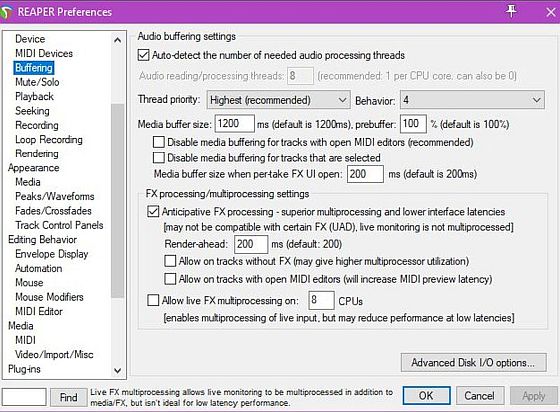

Thanks for the reply.
settingsd buf sm.jpg (61.55 KiB) Viewed 672 times
Reaper audio device Focusrite buffer size sample rate sm.jpg (50.01 KiB) Viewed 672 times
gp settings buffer.jpg (29.88 KiB) Viewed 672 times
On my old edrum module if I had it in any kind of editing mode, like changing volume, sensitivity etc, and I didn't exit out of it I would start getting mishits. Before I figured out the connection the between the Edrumin software and the midi noise I was on another forum trying to find out why all that noise and one said maybe I should change my latency, buffer settings. I don't understand them very well but I remember arriving at them through following the instructions of a loopback test. I was having trouble at that time with the VST not being in sync with the edrum sound. I'm not using them right now but I'd have to test against edrum sounds if I made any changes. By the way, I think being able to have edrumin software as big as I want as an advantage. I had one program, for my old module, that couldn't be made larger than a 1/4 of the page and it made it very hard to see.
