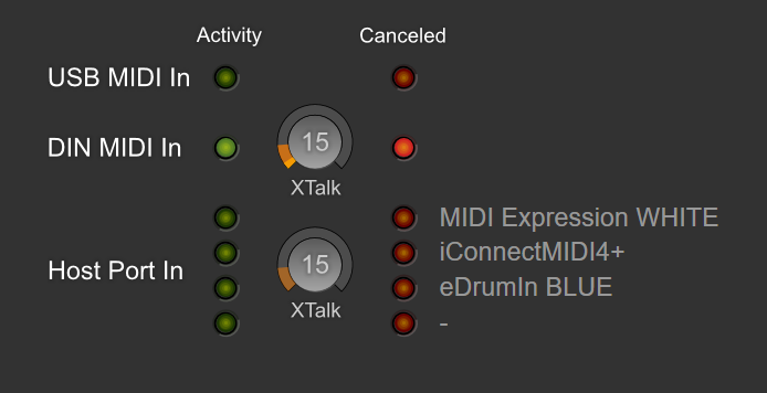

Re: Adjusting crosstalk cancellation of MIDI-IN notes
It's probably overkill, but here's what I've got so far. Should do the trick.
Tue Aug 03, 2021 8:54 am
Everything in the image is practical and will be useful. I like the activity and the canceled indications. Yes, the four individual indications and text for the up to four hosted devices is a bit extreme. However, if it’s not buggy and does not drive a bunch of issues for you I can see the benefit. It will be useful.
Will the activity indication only illuminate with a MIDI note, or any MIDI message (e.g MIDI note, CC, aftertouch, and PC)?
The GUI indicates that the USM MIDI In (I assume through the USB B port) has no cross talk control. Is that the case or is to be combined with the DIN MIDI In control? If the latter the GUI is confusing, seems to indicator the former.
