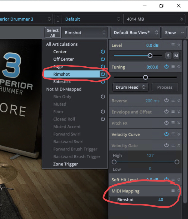

There is nothing special in SD3 you have to do. Other than making sure the articulation is turned on and that the eDRUMin is passing the correct MIDI note. Can you upload a picture of your trigger to show how you have it mounted? When you say “Closer to the mesh head” it leads me to believe you don’t have this set right. The cone is supposed to touch the mesh head.

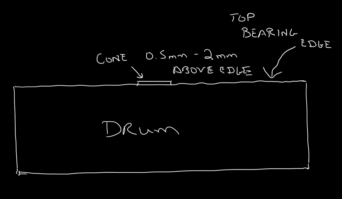

Here is a very crude drawing. When the mesh head is put on and tightened down it will touch the cone and press down on it a little.
Ok if it's supposed to touch then I do not have it setup right! Newbie error there. I'll get back to you, I misunderstood the bearing height.

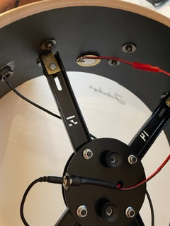

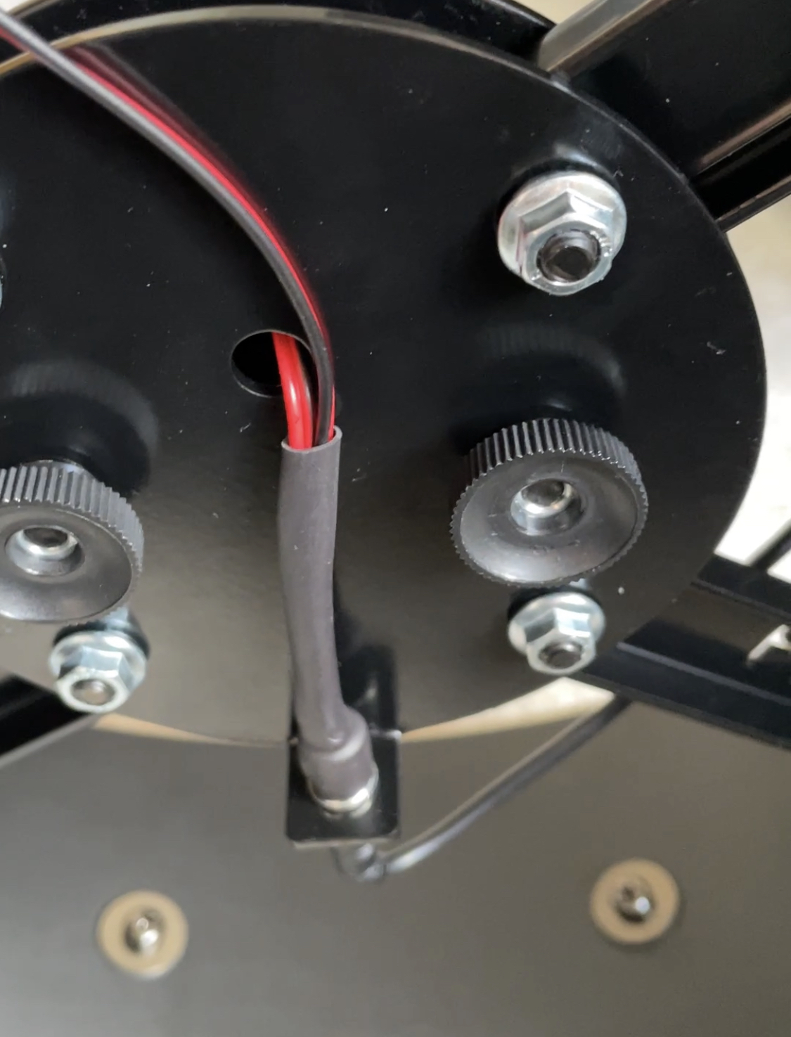

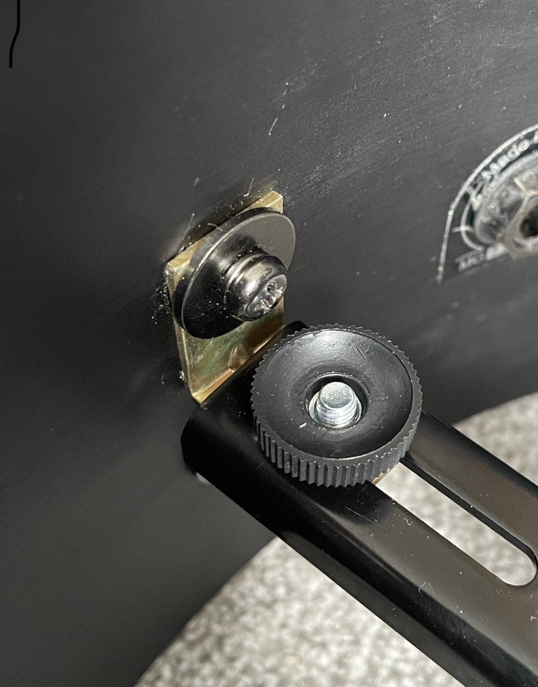

I actually can’t get it to the right height. There isn’t enough length in the jobeky height adjusting screws.
Attached picturws if It makes sense.
I tried to reverse the L shaped brackets but then it was far too high.
Re: False Rim Triggers
In your first picture you can place a couple of washers between the brass angle and the black arm. The bolt might not be long enough so a trip to the hardware store may be required.

i did exactly that thank you!
No false triggering now!
