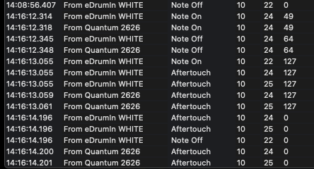

I have two ED10's, both are on 1.4.0.37. Previously, they were on .35. One of them will not send choke out via MIDI DIN. Whatever note I assign, it doesn't matter. The choke lights up when it should, and is sent over USB. But not sent over 5-pin MIDI jack. I confirmed this by capturing the MIDI from both USB and 5-pin. Capture attached.
On this capture, Quantum 2626 is the 5-pin MIDI in. eDRUMin WHITE is USB. note 22 is the choke. It's recorded from Quantum 2626, but not eDrumin WHITE. I have no idea why this is so. I first noticed it about 2 weeks ago. If I move the cymbals to the other ED10, choke works fine via 5-pin MIDI out. I have reset the device to factory defaults a few times, which was also necessary because my Channel 2 was stuck in Roland 3-Zone Bell mode. The choke issue persists.
Any suggestions on how I can fix it?

Confirmed and fixed. I also noticed that the MIDI channel wasn't being properly pulled from the Note Banks assignments and that has also been fixed. I'll post an update soon.

Build 38 is available from the BETA thread with a fix for this issue.
