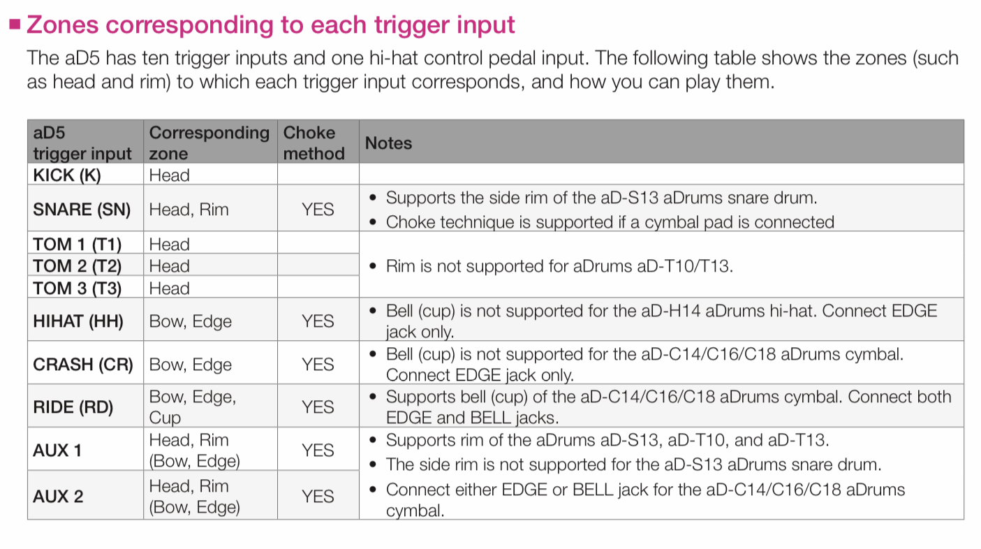

ATV info is very confusing. The site suggests that rim shots are available but the manual says otherwise.
Here are screen shots from the xD3 and aD5 manuals on what is supported.
The snare input is the only drum that supports rim triggering. Makes me wonder if they put a rim sensor in the snare as well as the three head sensors. The toms on the other hand all appear to be single zone pads.
Now none of that means Rob (aka The Wizard) can’t work some magic.

Mylo wrote:ATV info is very confusing. The site suggests that rim shots are available but the manual says otherwise.
the pic I posted is exactly the same way the 10" ATV drums are setup they have 3 piezos inside them the kickdrum I think even uses the same 3 piezos afaik(haven't opened it & you can't see through thick meshthe kickdrum utilizes)
