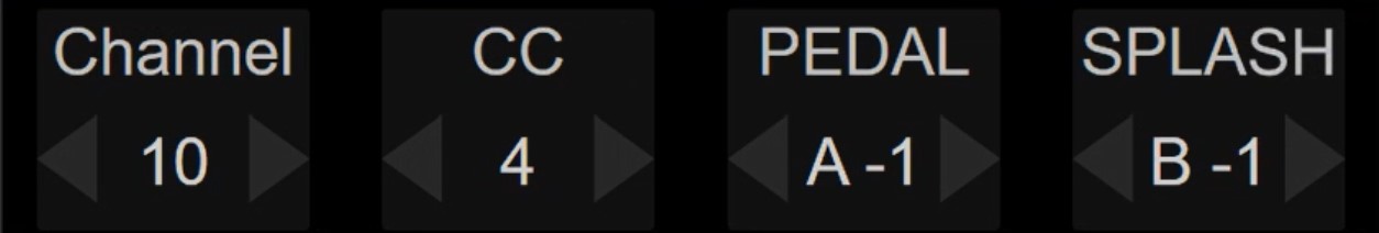

Thanks, it's gone the other way and now always sounds open?
Re: Wacky hi-hat using eDRUMin
I really don't know how to help you because I don't know what you've done in SD3. Assuming that you are using the SD3 preset inside of SD3, these are the notes for your hihat.
Screenshot 2020-10-22 225313.jpg (21.9 KiB) Viewed 980 times
And here are the notes for the hihat pedal.
Screenshot 2020-10-22 225433.jpg (28.07 KiB) Viewed 980 times

Thank you very much, I've just changed settings as shown and that seems to have made the difference. I will test it out properly later.
