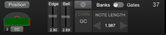

So I set all my cymbals to 2 sec and still get no choke in Ableton???
Am I missing a step?
Here is what some of my cymbal settings look like in ED:
Note the 13 inch crash keeps resetting to .003

OK, so I turned off MPE and Track in the Ableton settings for the eDRUMin and got the choke working!
(not sure what track is for?)
Re: Choke gone in Ableton
I think you need to to keep 'Track' enabled, but MPE should definitely be off.
