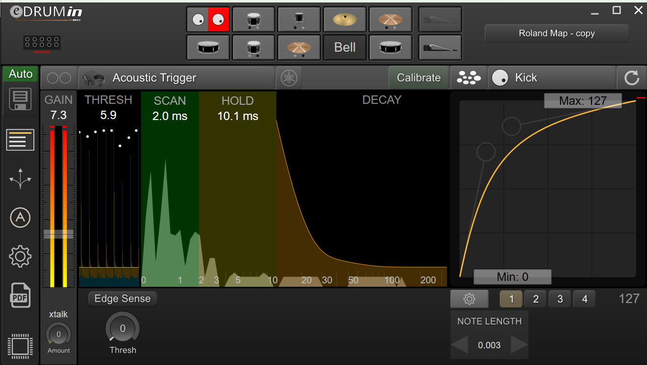

Hi Rob, thanks for getting back. I changed the input to acoustic trigger, and went through the setup again as per your Transient Scanning Controls video. I'm still getting a bit of drop outs but it is better. Here is a screenshot - I notice the transients are minimal compared to a standard mesh head - I guess because there is no resonance at all in this type of trigger?
thanks
