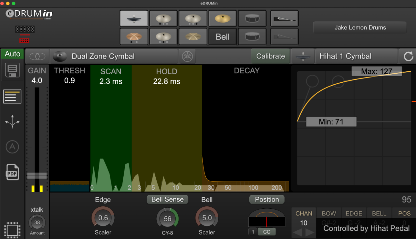

Loving the edrumin units and very happy with how i have my shells and other cymbals dialed in, but not quite happy with the hi hats settings yet in testing with various drum plugins , often the pedal is slightly delayed when opening for an accent and sometimes it's just missing regular hits but in edrumin when i look at it while playing it seems to catch them at least visually - i have two hats to to test ( 12 and 15 inch i belive and() it's likely a setting I'm missing. If anyone could take a look at the current settings if something looks off based on typical settings, it feels close to me playing but is missing a bit , thanks!

It's hard to tell for sure, but your settings don't seem optimal. At first glance, your hihat cymbal hold seems too long and decay seems too aggressive. I also don't understand why you have the lowest velocity for your hihat starting at 71. Also, turn bell sense off because it doesn't work with Lemon cymbals.
Have you watched any of my videos about setting up pads and hihat controllers?

Thanks, i have watched but it's been many months since I've used it and was sitting a while, I'll watch the video again , was playing around with settings seeing what would work better or worse.

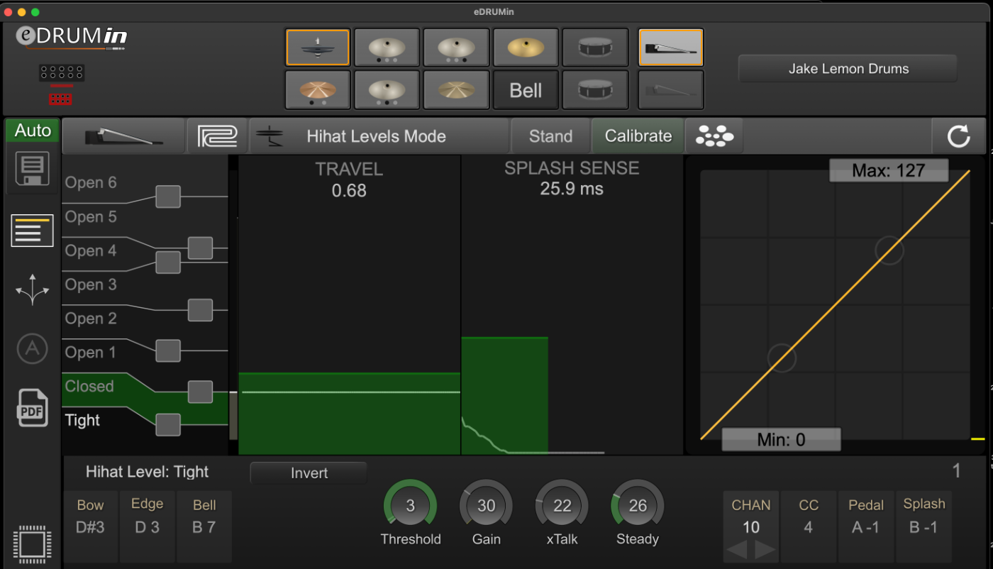

That seems to be slightly better now after watching your hi-hat video but when the pedal is closed tight all the way on mine i can't get any hits to trigger at all - which i think is my main issue. any advice on that?
