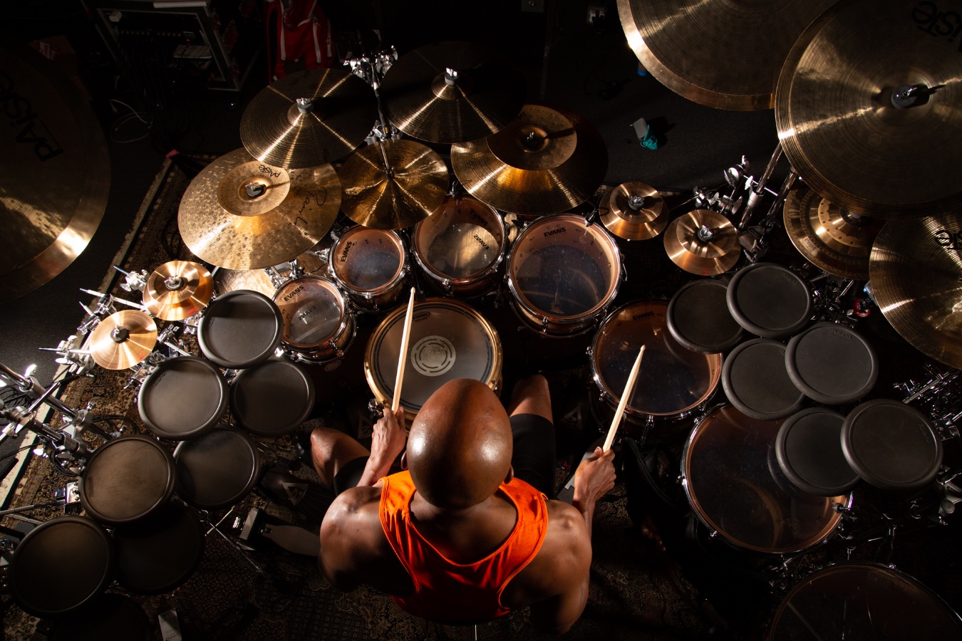

So I’m trying to run a all Roland pd8 setup and I’m fiddling around with setting up a preset but not sure I’m understanding how to drag and drop from a drum map or if I even need to be fooling with a map. Is there a way to map from a clean slate? I’ll leave a pic so you can see what I’m trying to do. I’m essentially just using a bunch of pads to integrate into my existing setup like a ferry Bozzio type of deal with dedicated notes. I’m using and ed10 and ed4 with the pads and the 2 Roland trigger pedals you can’t really see. Native Intruments Battery 4 is handling samples. Most of this is maybe learning curve stuff just understanding presets and customs notes. Everybody chime in! Thanks

If you have an extremely customized setup, as yours seems to be, then using a drum map is probably not going to be of much help. You probably would be better off setting your pads to use 'Custom Notes'
If you are only using PD8 pads, then I would get one pad sounding good in terms of triggering and dynamics and then same a preset for it. Then you can use that same preset for your other pads, and simply change the notes that each pad triggers.
