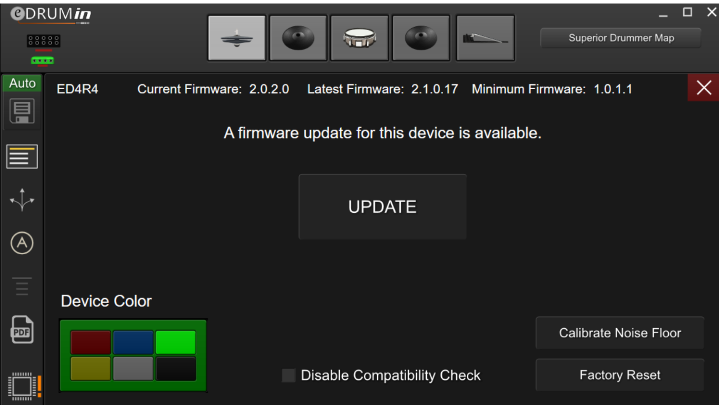

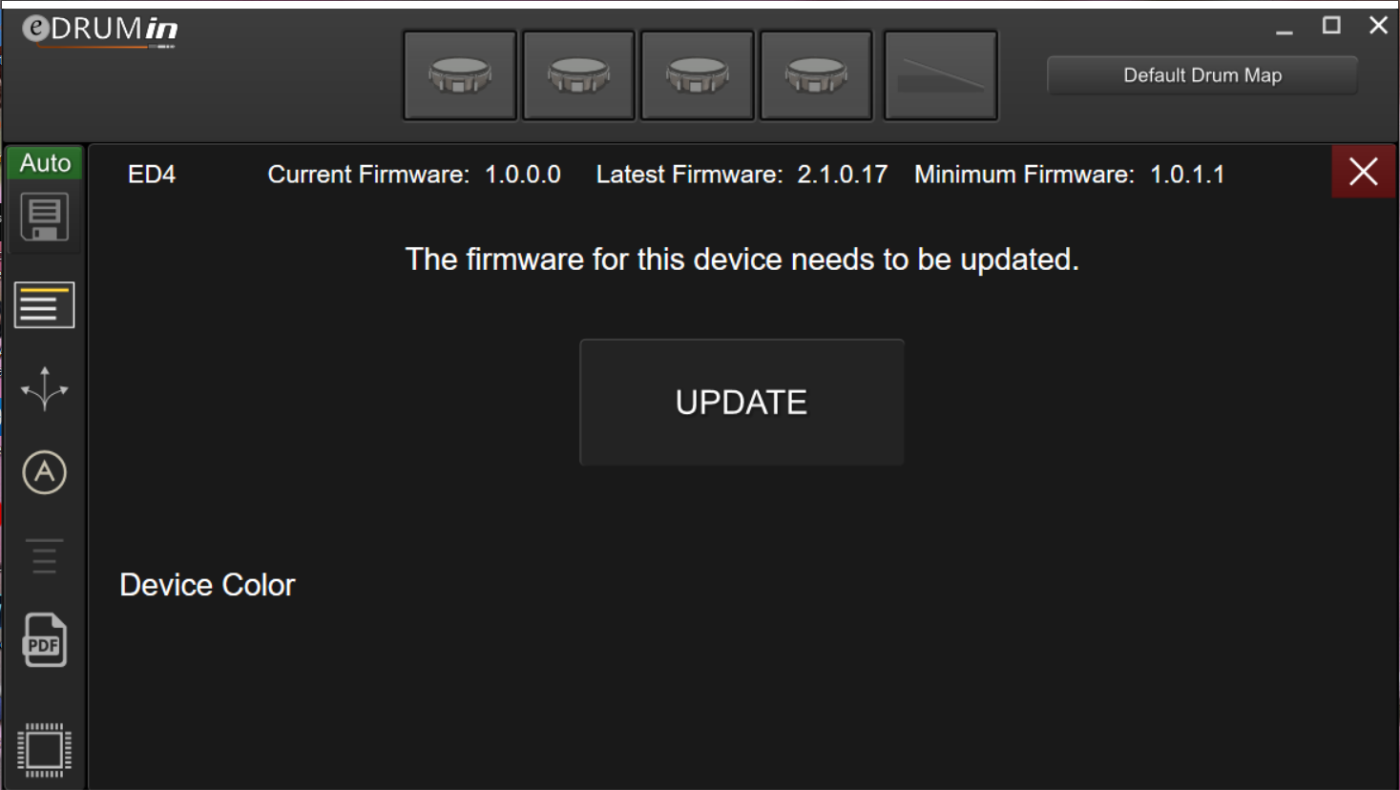

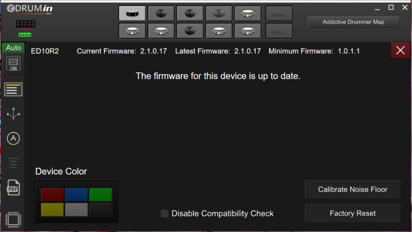

Can you do another screenshot of your firmware section. I think you might have the wrong firmware revision installed.

Once I restarted again it did the same. I did the update then checked it and it wanted another update this time. So I did.

Good day Rob. Issue is still happening. When they have been powered off for more than few minutes it keeps wanting to update firmware on startup. Only the ED4 but neither will work until update is done, then work fine until next power off.

Your device is an ED4R4. Older versions of the control application do not have firmware for that device. I recommend using the latest version of the Control Application, and at least version 2.1. It seems to me there's a good chance you have managed to install the wrong firmware on your device.
Please send me an email to support at audiofront dot net and I'll help you get the device up and running properly.
