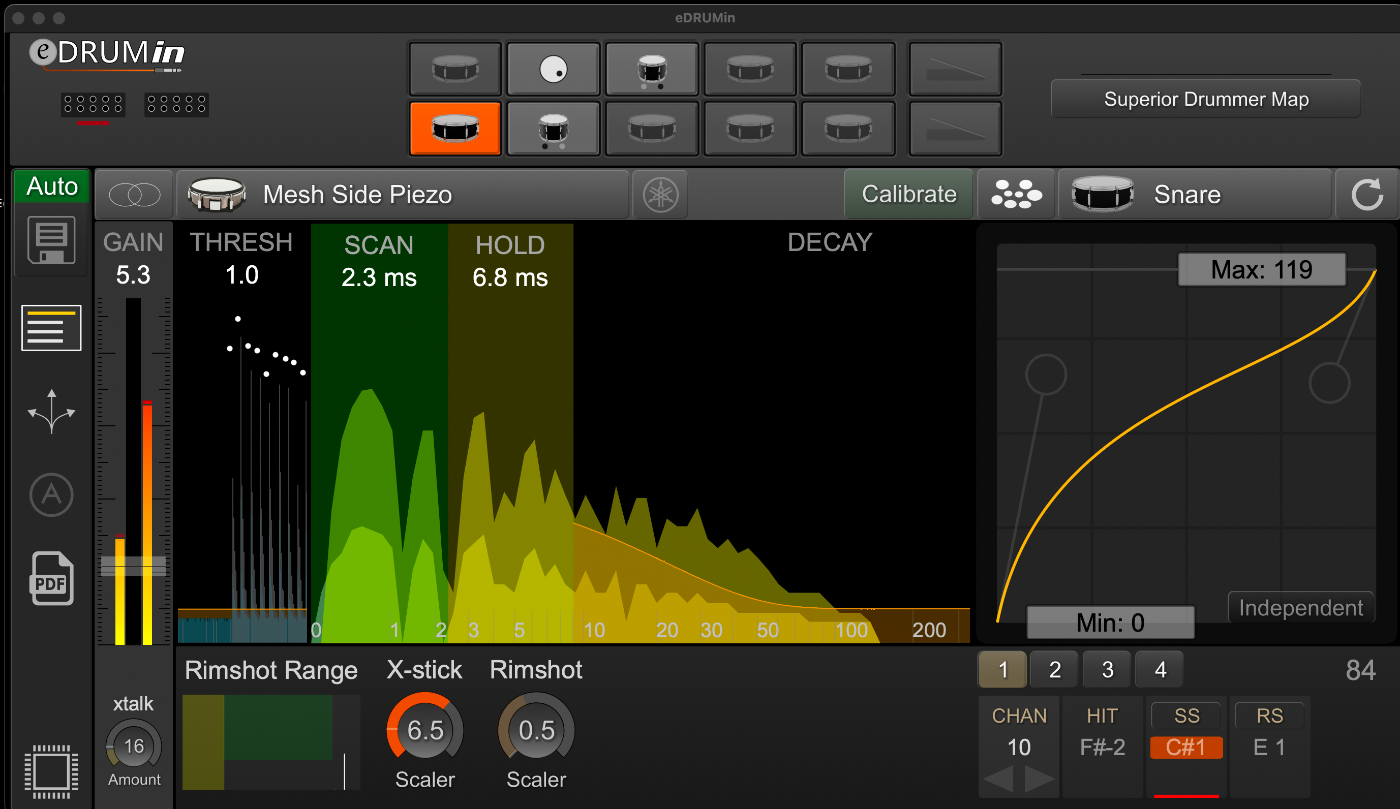

Ok I am officially at a loss here. I am starting to think that the Groovedot + Groovebar triggers and the Edrumin don't go well together
Now after restarting my computer, all the triggers, even the ones that were working properly. Are inverted. I think there is some compatibility issue here and thinking about returning the Drumtecs and just get the Roland RT-30HR which are listed as compatible. Thoughts?
Screenshot 2023-05-16 at 16.49.33.png (785.75 KiB) Viewed 2176 times

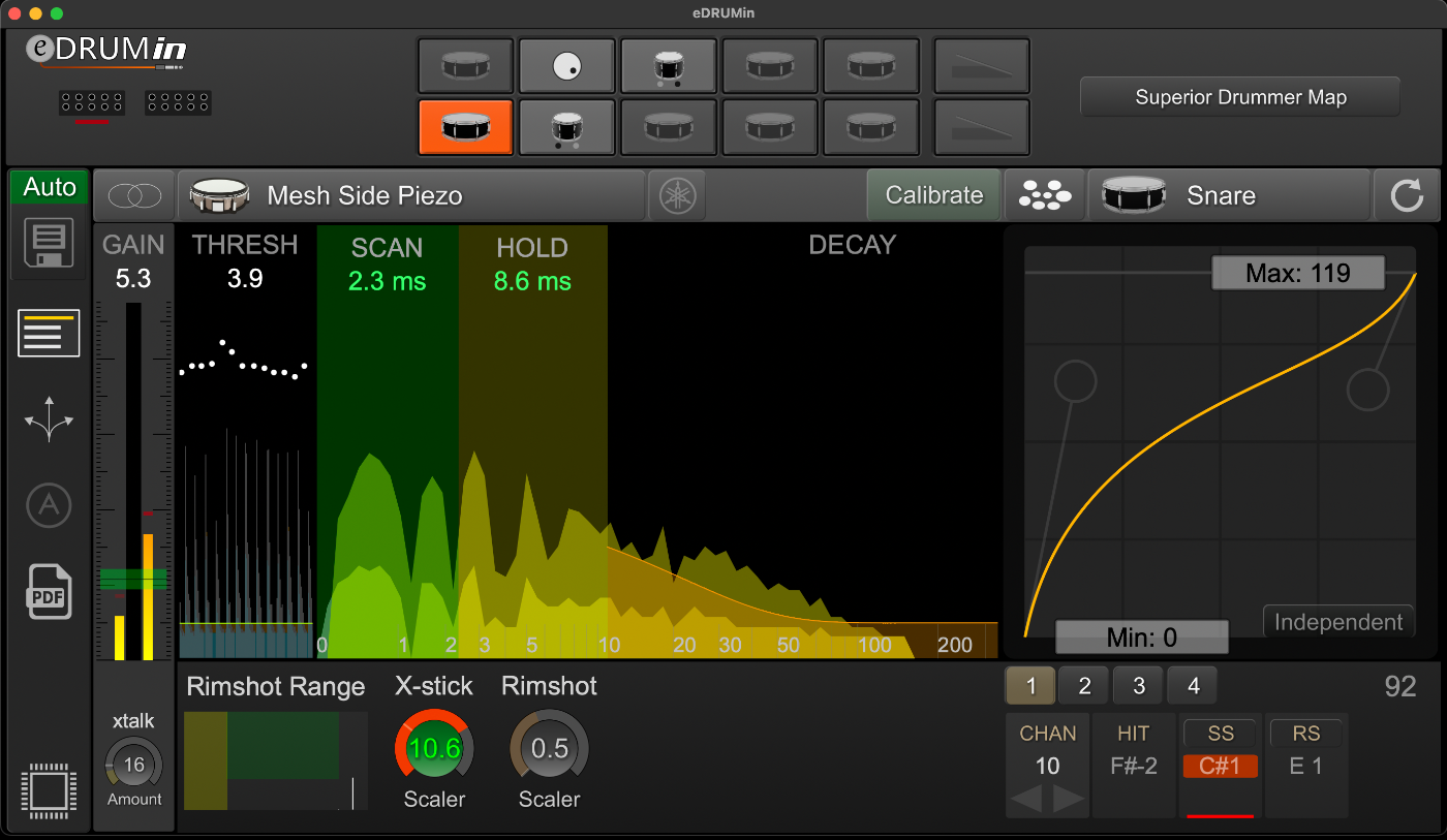

Screenshot 2023-05-16 at 16.47.36.png (789.89 KiB) Viewed 2176 times

Triggers are pretty simple devices, so something else must be wrong
It's late here, bit I'll see if I'm able to reproduce your inverted issue tomorrow. I tried breiffly earlier this evening, but no such luck.
Also, you should probably have the pad type set to 'acoustic trigger'.

Re: Same trigger, same position but different behaviour?
I tested some more today, and I'm pretty confident there is no bug causing the signal to be inverted. Based on all the images you have sent, my best guess is that your triggers are not mounted high enough, and so the head of your drum is not activating the head sensor of the trigger properly.

To me it looks like you need to relax the decay, raise your threshold a bit and reduce the gain a lot. Even with new triggers those settings look problematic.
