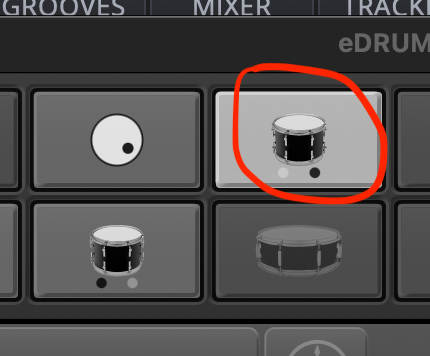

Hi! I am having a bit of a headache figuring out what I am doing wrong.
I mounted two Drumtec Groovedots in my toms and while I got one to work OK. In the other the 'dots' are reversed and when I strike the center of the head the 'SS' lights up instead of the 'HIT' - Is there a way to reverse those dots.
Screenshot 2023-05-16 at 08.33.09.png (108.79 KiB) Viewed 2551 times

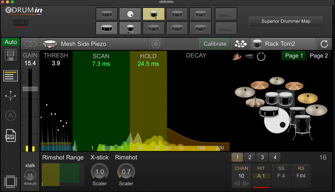

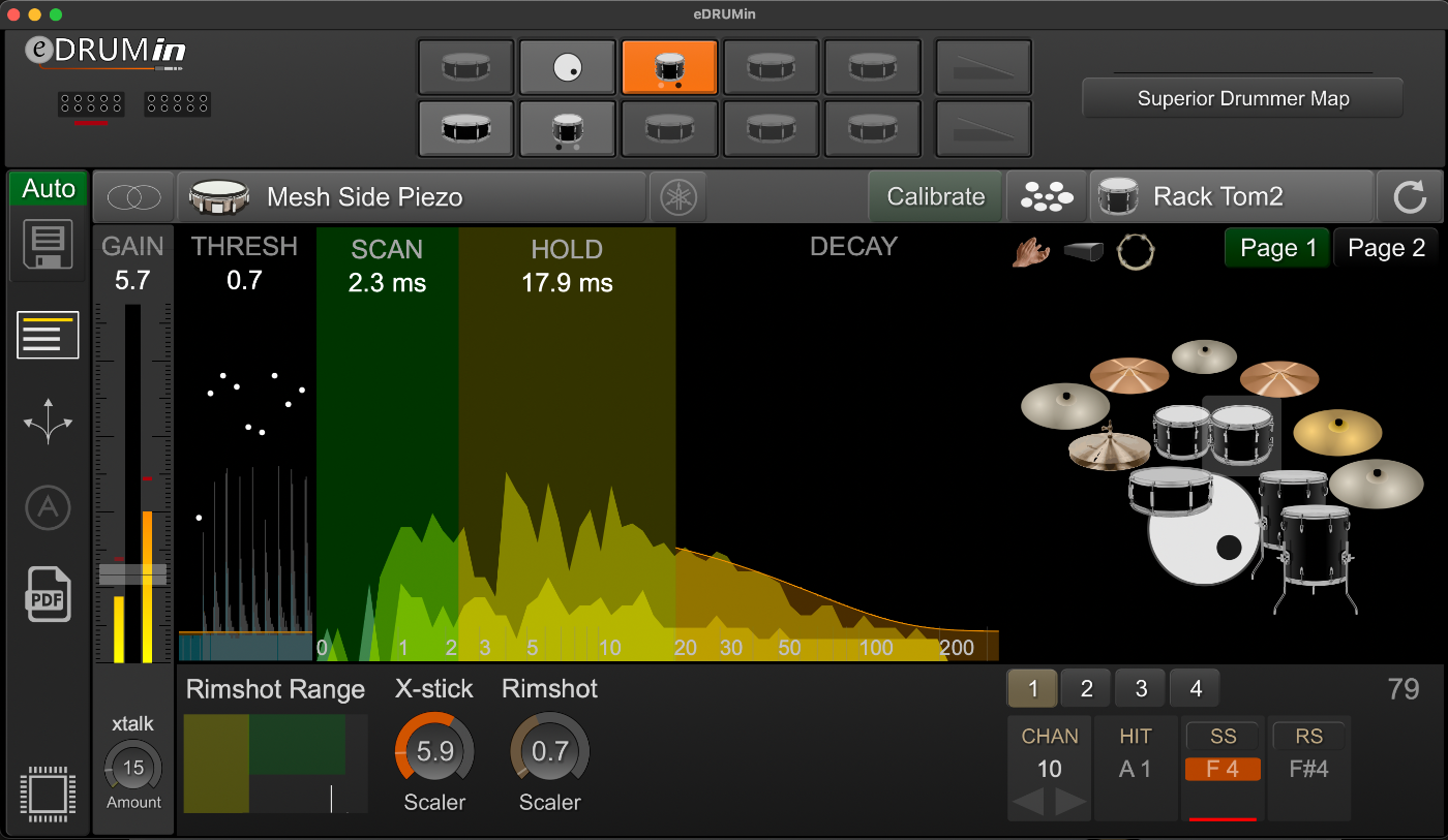

So just to be clear the dots do not affect the hit / sidestick.
For the pad that is trigging the ss when you hit the head, can you please post a screenshot of your settings?
AndreaZanini
Posts: 34
Joined: Sat Aug 14, 2021 7:36 pm
Contact:
Re: Same trigger, same position but different behaviour?
Post by AndreaZanini »
Sure! Here they are.
Rack Tom 2.png (783.87 KiB) Viewed 2538 times
Floor Tom.png (789.64 KiB) Viewed 2538 times
____
Andy
The rim signal is very strong compared to the head, are you sure the trigger is mounted well?
It will definitely affect things. When you hit the head of the pad, the left VU meter should generally be higher than the right
