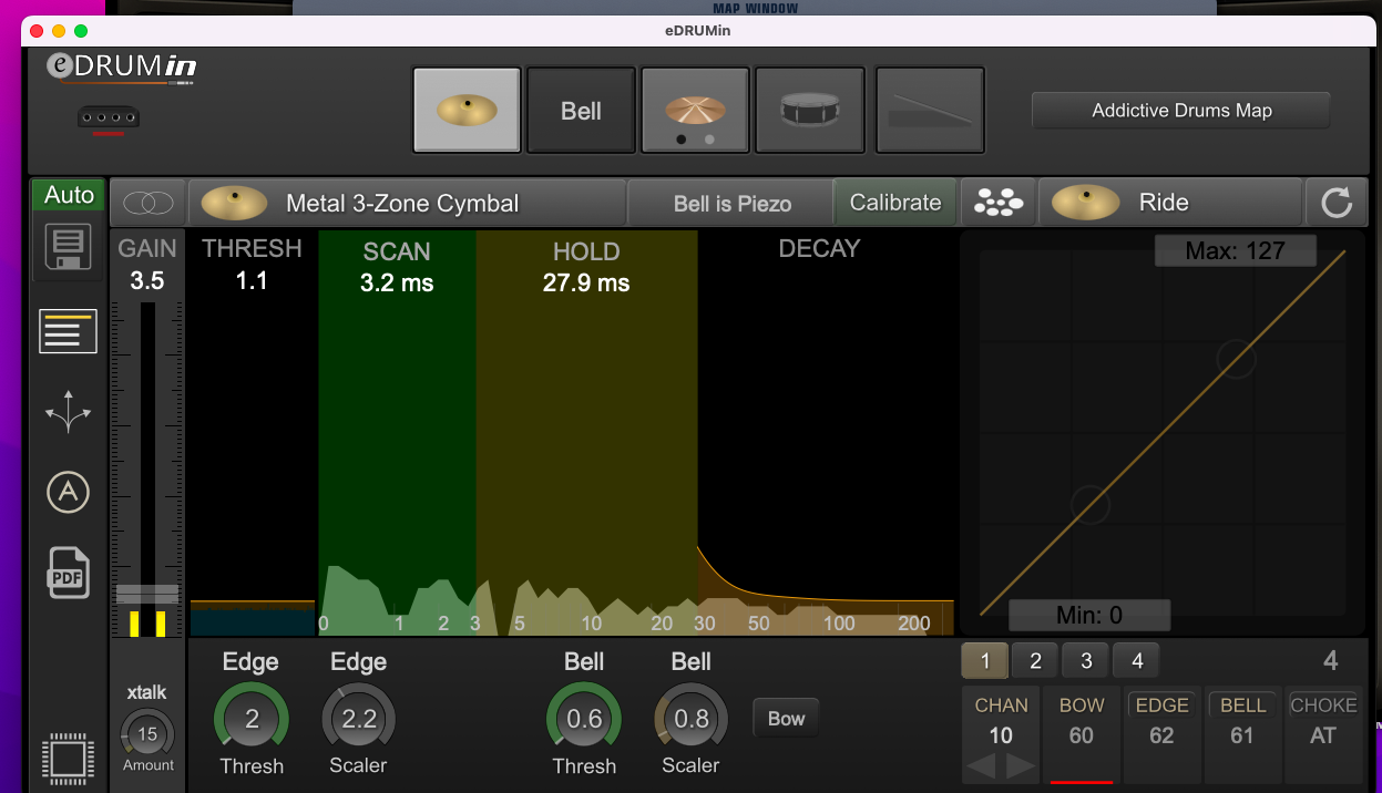

Hi Rob, sorry not getting back.
guess i was confused about you mentioning input 1 and 2 were seen as 3 zone and you were going to fix it.
But, in any case, i pulled cables and reconnected, pull usb and plugged that back in, and restarted edrumin. Looks like everything is working as expected. Must have been a long night i guess.
But, this is very cool. Glad i waited to DIY the 3 zone ride until I got the long awaited new deliveries on your modules :D
Now onward to the HiHat :roll:
sorry wasting your time and effort !!

Re: Metal 3 zone Ride no response?
Ronyd wrote:
Thu Nov 17, 2022 6:49 pm
I did fix that issue, thanks for reporting it. I typically make a reply in the BETA thread that I posted a new build and then update the download links on the original post (currently 2.1.1.4). Glad everything seems to be in order.
aaah ok Rob thankx. I'll make sure i always check the updates..thankx again
