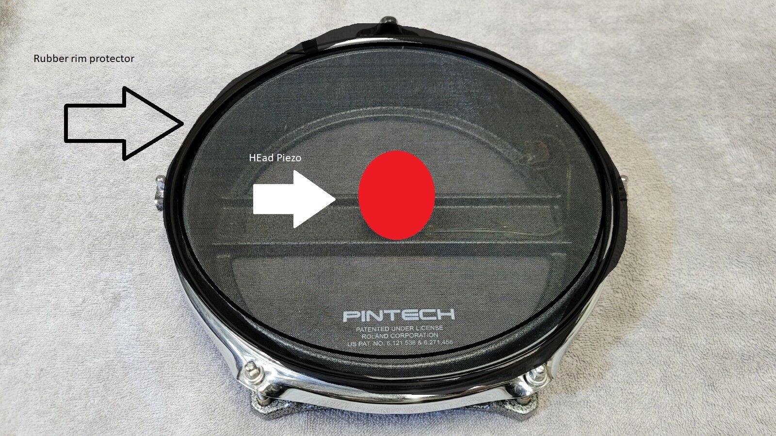

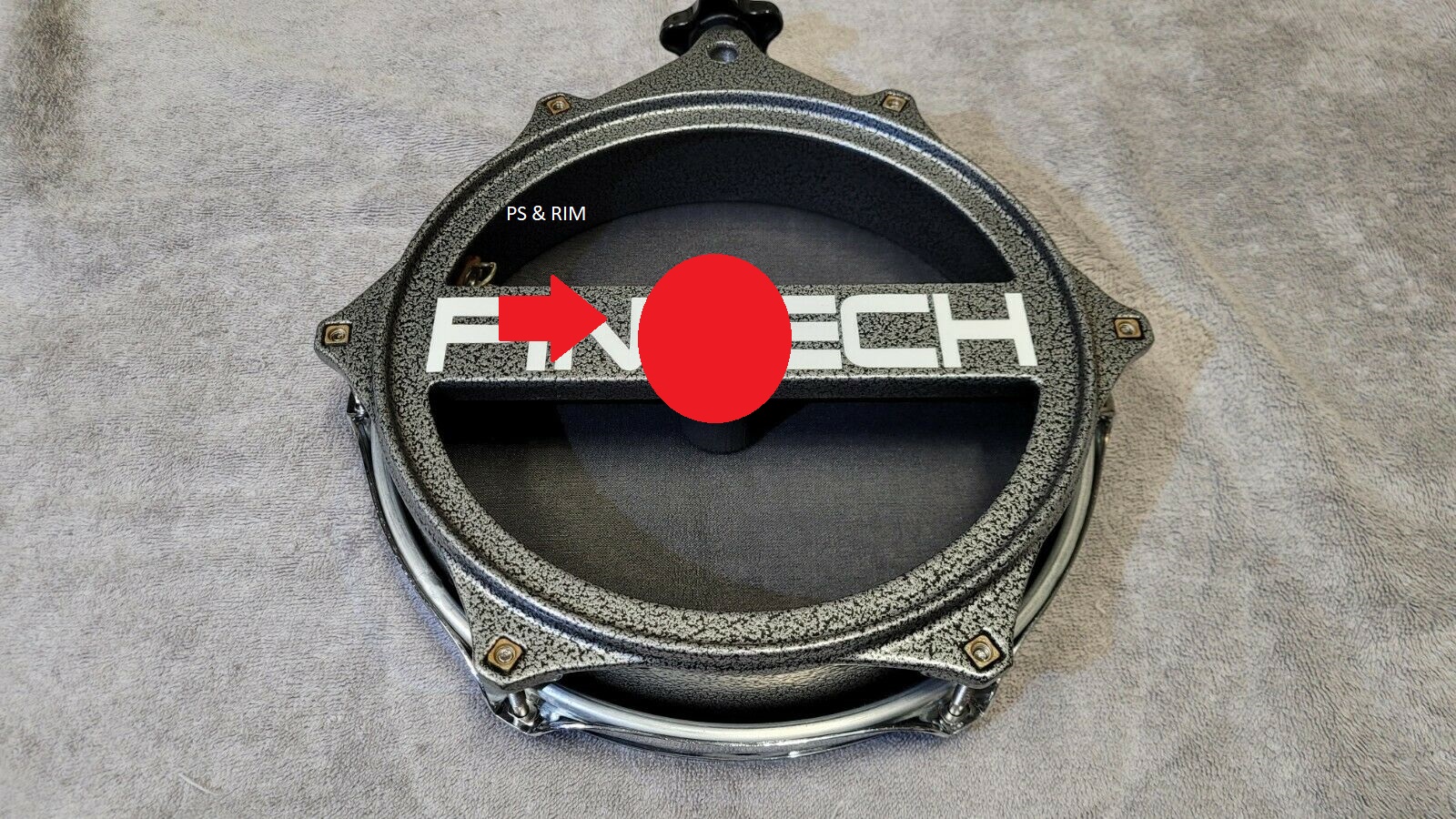

ok i was thinking if all pads had positional sensing it would really add another dimension of realism .. rob let me ask you this.
based on these pictures of my drums
if you were to build a DYI and wanted PS and rim where would you put the piezos?
or whats the best configuration I can build anything . I could gut these out and cut the center bar out to create the best configuration.. how would you do it ?
Re: Just because I'm crazy as a fox
I would try mounting the head sensor on top of the bar, and the rim sensor underneath, both centered.
