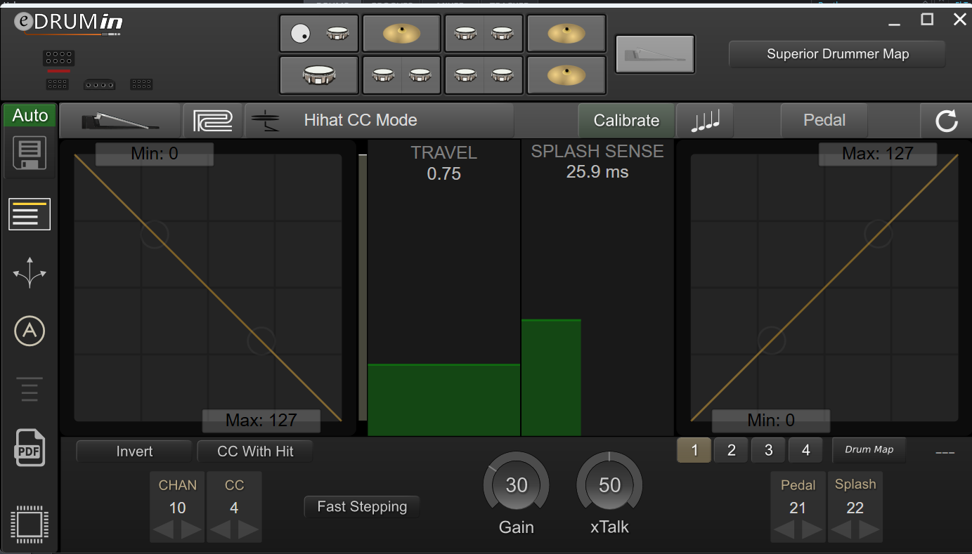

hi hat settings
Posts: 4871
Re: ghost triggering of one pad
Not much to see in your screenshot, unfortunately. Have you looked in the eDRUMin MIDI Monitor to see which input is producing the unwanted note?
