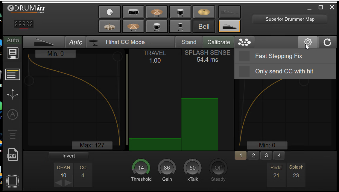

On the eDRUMin pedal input settings, can you click on that cog just above the velocity curve and check to make sure 'only send cc with hit' is not enabled.

Nope, it's not
03-15-2024, 13-10-23.png (265.68 KiB) Viewed 3487 times

Can you try changing your polarity settings from 'auto' to 'Roland'

Sure. No change whatsoever as if the 'Auto' discovers/selects just 'Roland' polarity.

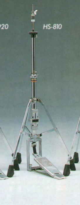

I setup the second stand I got for your hall effect sensor. This Yamaha HS-810 stand is old but better than the one I've been using (Ludwig one that came with the Accent Combo kit from around 2008) It also has an ideal setup for adding the sensor - there's an empty threaded hole on the foot plate right near where the pedal meets the rod connector.
03-23-2024, 12-43-38.png (274.4 KiB) Viewed 3384 times
My unit is the ED10R1 - I probably need to "update" it to the new version to use your hall effect sensor. Is that correct?
I plugged it in for a second and it acted very oddly. Can plugging in the TI sensor cause issues for the pedal input? Maybe I'm about to find out when I plug the other stand back in.
UPDATE - back on old stand with SS49E and it's working as usual. During this I updated to 2.3.1.23. I noticed that the hi-hat pedal calibration now shows the voltage. I get 1.22 to 1.75 with my SS49E
A while back I built a 5v inline "injector" in a project box - I plugged the pedal input into the project box and it had a TRS that went into the pedal input on the ED10R1. Would that allow an ED10R1 to work with the TI sensor?

Ya, that TI sensor will not work with ED10R1, but you could pick up an ED4 to handle your hihat and that sensor.

Thanks for confirmation on that. SS49E is working well. Might swap our ED10R1 for ED10R2 in the future, always happy to shop at AudioFront! :D
