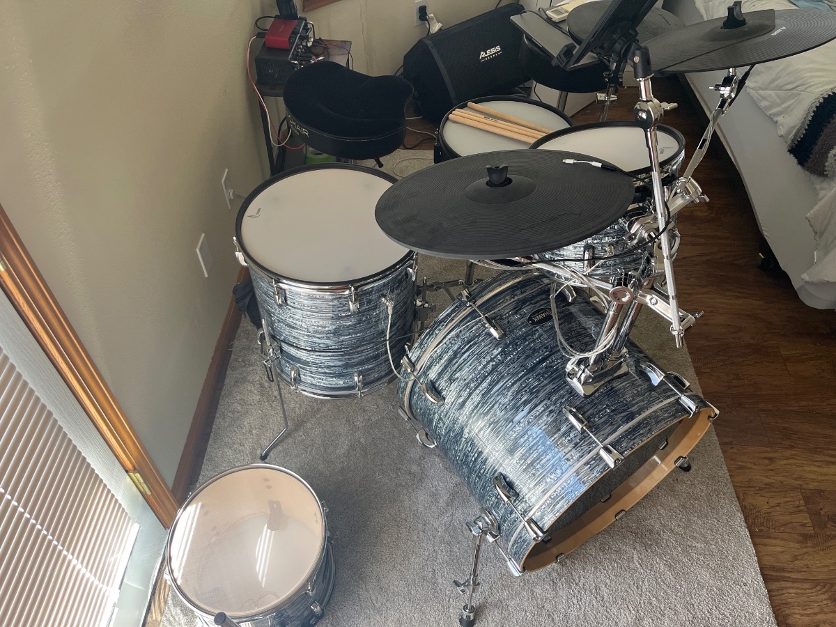

I honestly would buy another Hall effect sensor. I plan to build out a 2nd ED10 kit soon. Just looking for the right shells at the moment. My first kit is using a Hawk converted shell pack from edrumcenter, and they are awesome. Will likely go with them again. $129 per converted drum for their talon 3 triggers. Paid $1500 for these shells shipped, including the detached rack tom sitting on the floor.

Here’s some pics. The calibration line bounces around even when the hardware is sitting completely still, so maybe you’re right about it not getting enough power? I have the eDRUMin 10 connected to a MacBook Pro M2. How can I test that possibility? I did try the other pedal jack with no difference. It also doesn’t seems to matter how close the magnet gets. If loosen the hihat clutch and push the pedal all the way down, it behaves the same. I checked your solders inside the sensor unit as well, and they look good to me.
