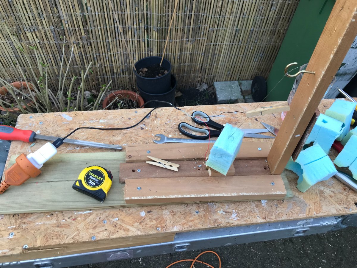

I have some results! As mentioned I took a sidestep into trying to make my own foam cones, and in order to do so I made a DIY hot wire foam cutter that can cut cone shapes. I tried making it work with some power adapters that I had laying around, and in the end I was able to use a 5V 2.4A Apple USB adapter to get a +-20 cm 0.4mm nichrome wire at about 200 degrees, which was enough to cut the foam. Ideally it would be a bit hotter, as now the foam was still too resistant, making the foam bend more while cutting, resulting in a rougher and uneven shapes (see pics).

Did you try attaching blocks of foam to a drill so you can make the cones smooth?

no i have not, but ill give it a try next timeELEGENT DRUM wrote: ↑Tue Mar 11, 2025 7:27 amDid you try attaching blocks of foam to a drill so you can make the cones smooth?
