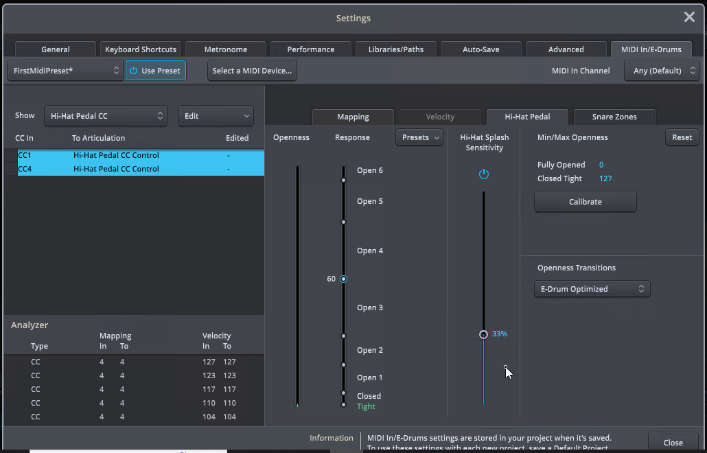

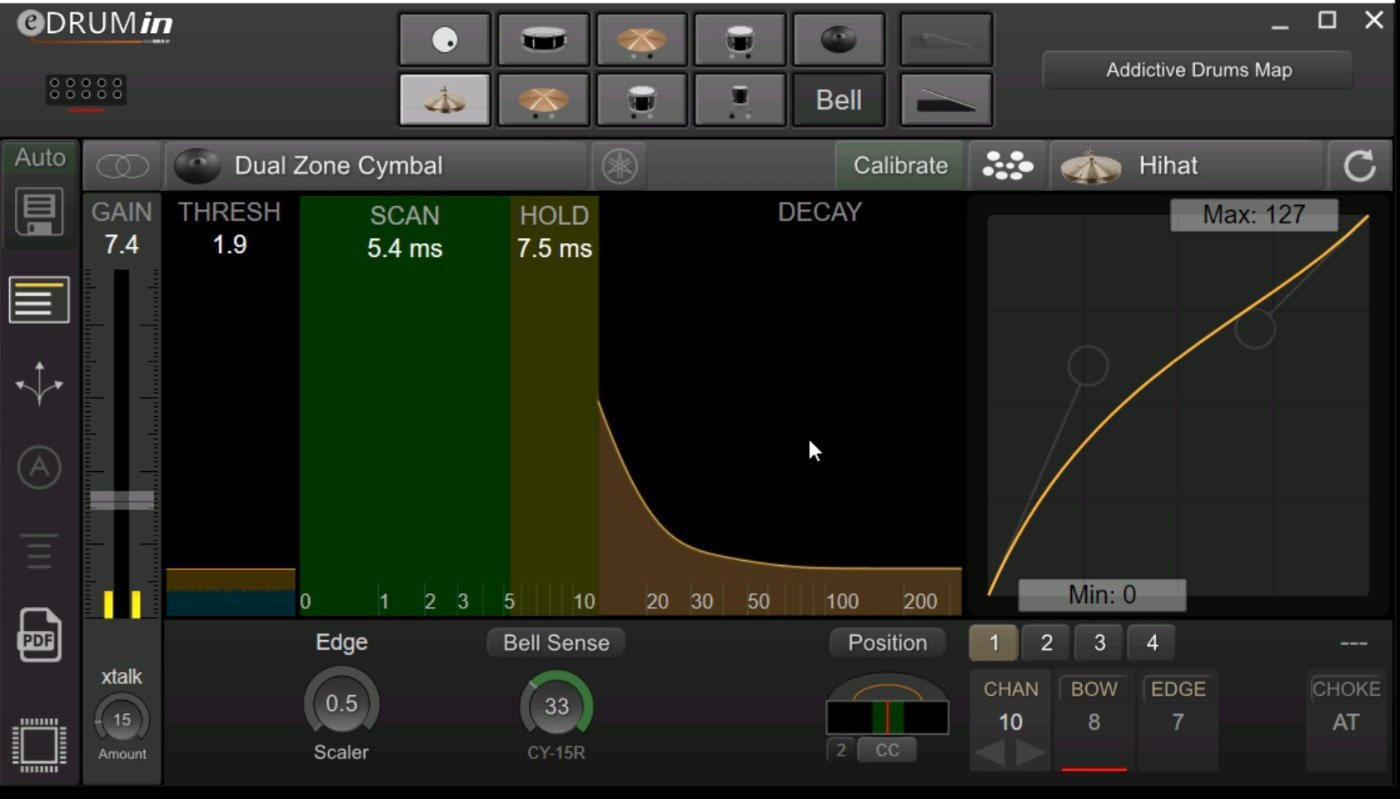

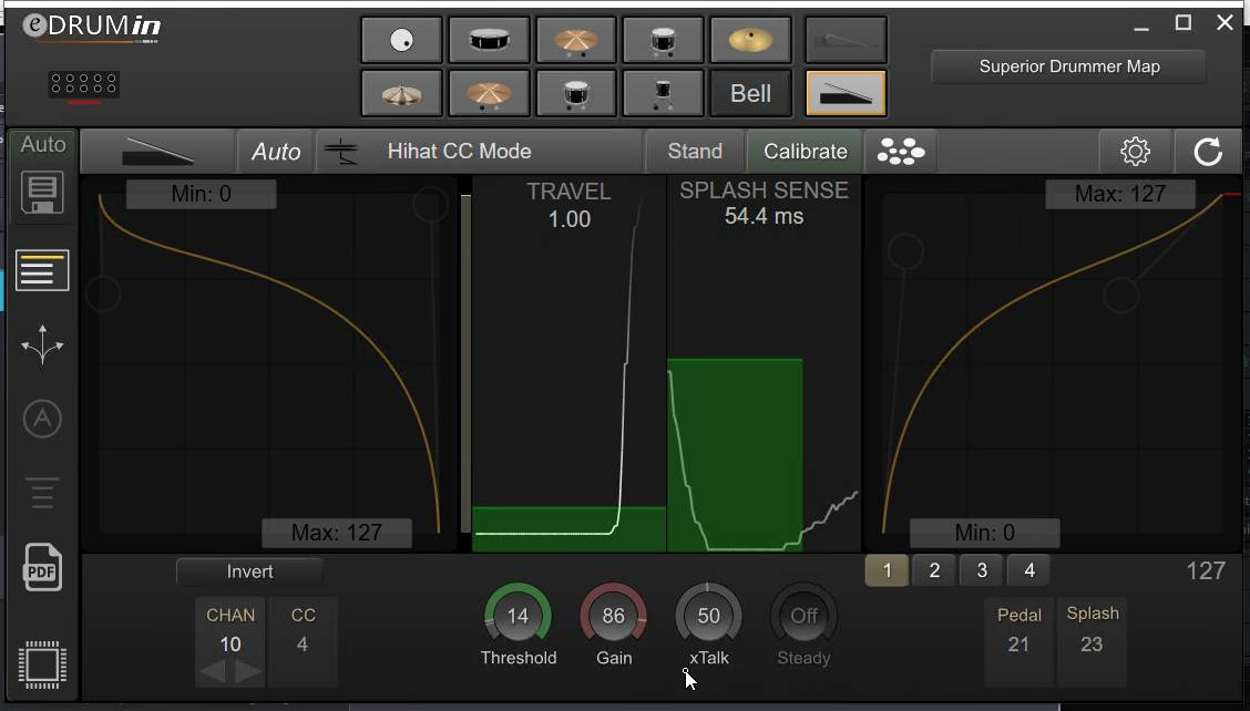

... let me ask you one question, which bothers me for some time already.
First the scenario:
1. I hit fully open hi-hat
2. Then I close slowly, to avoid chick
3. I reach the end (fully closed), cc 127 is sent to Addictive Drums (I see it arriving there, see screenshot)... but I can still hear the sound of the hi-hat's cymbal (for some time, of course)
Is it normal? Should I configure something differently?
Should edrumin send something else?
... is it the matter/fault of Addictive Drums?
This is Hall Effect sensor build, the one from the manual, powered from edrumin.
Attached screenshots from AD2 and edrumin

Re: Help with hi-hat closure
It's probably something programmed into Addictive Drummer. One thing you might check is your expression curve on your hihat CC. You're doing much the opposite of what I normally want. Once I get to an almost closed position, I want the pedal CC to change very slowly in order to give me lots of definition in that area. You have things setup so that once it's close to closed, if will jump very quickly to fully closed. Maybe AD sees that quick change and infers that the pedal is being pressed hard and therefore triggers some kind of sound.

Rob, I followed you advice and bought SD3. But... the problem persists. Tell me, if you hit the open hi-hat and close it slowly, to avoid chick, does it get muted when closed?
I attach my screenshots (I switched off all curves)

Yes Rob, this is exactly what I am expecting. And what does not happen in my case 😔
I asked this way, because I cannot belive that this is working for you 😆
I guess you cannot help, if you cannot reproduce...
I also updated to 2.3.1.23 from 2.3.1.20. Still the same.
Also here, in SD3, I can see cc127 arriving (one of the screenshots from my last post), so this is probably not related to hall effect sensor...
