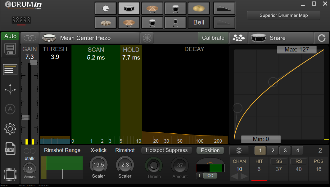

Hi again, my snare settings as promised
02-21-2025, 08-56-03.png (143.3 KiB) Viewed 5294 times

Cool thanks for sharing.
