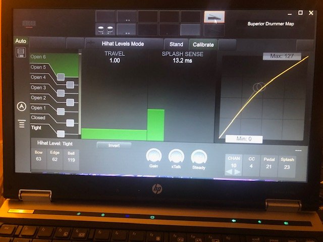

(1) When opening the app, half of the icons on the left side of the screen are missing, as are the edrumin logo and icons of the active devices at the top on the left side. Pressing the "restore" button brings the missing icons back. This happens consistently upon opening.
That's probably because the images haven't finished rendering. Why OS are you on and what "restore" button are you talking about?

(1) Screenshot of hat controller page. Notice the missing icons on left side. The "restore" button is the middle one between the minimize and close buttons in the upper right corner. Maybe its actually called "resize". Anyway, hitting that restores all the icons. I'm using Windows 10 on a 13" laptop.
edrumin screen shot.jpg (81.62 KiB) Viewed 15460 times
